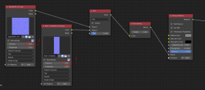

Is there a way to do the normal map conversion later in the node tree and not in the Image node, so I can do normal maps operations?
Yes, there is a normalmap node that takes color as input and outputs bump. However, it is not accessible through the "add nodes" menu because it confused too many users. You can add it by typing this into a Blender Python console:
D.node_groups['your material'].nodes.new("LuxCoreNodeTexNormalmap")
Make sure to set your imagemaps to gamma = 1 if you use this.
the hidden normalmap node
