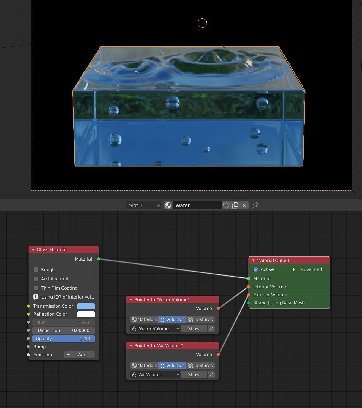

Ideally, I would create two separate materials. LuxCore has the concept volumes being separate from the material, and you can assign different volumes to the interior or exterior of a material.
To create this I used 2 volumes:
- Air: IoR 1.0, Priority 1
- Water: IoR 1.33, Priority 0 (default)
When volumes intersect, the higher priority volume is used. That way the bubbles can be modelled as usual, with normals facing outside.
Using the volumes for these materials:
- Water: Glass, Interior 'Water', Exterior 'Air'
- Air: Glass, Interior 'Air', Exterior 'Water'
When the water and air volume intersect where the bubbles are, the air volume is used as it has a higher priority.

If I'm not mistaking, you can leave away the volume nodes in the water material. Only the air material needs both volume nodes.

Some notes from my side:
  • You don't need volumes for this particular case, using a single material and inverting the bubble normals is fine. Volumes are mostly required if you have more than one transmissive medium interacting with each other. However, they are also required for volumetric effects (absorption, scattering) which is why I used a single volume for the water material here (see below)
  • For physically correct absorption, use a volume with absorption color instead of the glass transmission color. It vastly improves the realism here, because the transmission color is simply applied at each bounce, while the absorption color takes the distance traveled into account and is independent from the bounce count.
  • This particular scene doesn't require "add light tracing" or the caustics cache, so I turned them off
  • I wouldn't use rough glass for water, but that's a matter of artistic decisions for the desired result
  • To capture all relevant specular bounces in the glass, you might need to raise the total and specular depths. In this scene I raised the depth step by step during a viewport render, until all black spots were gone. I ended up with 10 required bounces.

Here's the end result. Thanks again for your help.
