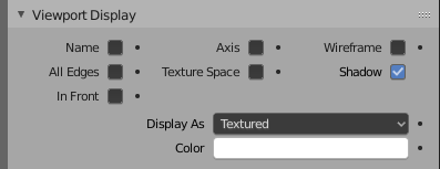

Dade wrote: Sat May 23, 2020 6:29 pm The most efficient solution should be to make the light cover "light transparent"
Thank You, but where is this setting? I only know this:
Re: Lighting Strategy for lamps with cover
Posted: Sat May 23, 2020 8:27 pm
by Snowcarver
I finally get it. It's about that. Thanks again!
