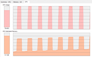

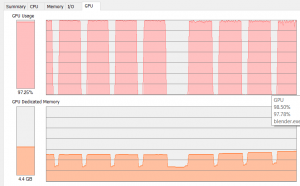

Edit 6: Decided to test it - switched from CUDA back to OpenCL and rendered a few frames. The difference is quite noticeable:
- CUDA (left) vs OpenCL (right)
