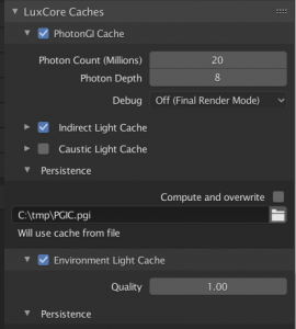

Set Env. Light Caching Quality to 1.0. This should help.
LuxCoreCaches
LuxCoreCaches

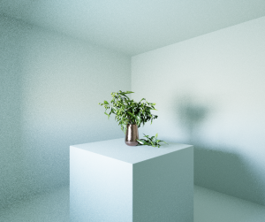

Just a short render test:
Env. Light Caching_CPU, clamp 0.1, 256 samples, 0.75x, env. light q. 1.0
