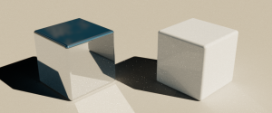

When using a HDRi with light tracing, it looks like the shadows are a lot darker, as if only the sun is used in the image. This seems to only happen when using OpenCL, CPU looks as it should.
The attachment 0001.png is no longer available
![0001.png (611.58 KiB) Viewed 4346 times OpenCL + Light Tracing + Caustic Cache](./download/file.php?id=7438&t=1&sid=8280afebccdf2f979665bb313895b96d)
- OpenCL + Light Tracing + Caustic Cache

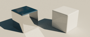

There are also a lot of fireflies in this scene, not sure why as caustic paths should be accounted for with the cache.
![0002.png (561.19 KiB) Viewed 4346 times OpenCL + Caustic Cache](./download/file.php?id=7439&t=1&sid=8280afebccdf2f979665bb313895b96d)
- OpenCL + Caustic Cache

What LuxCore version are you using ?
Re: HDRi and Light Tracing
Posted: Tue Apr 07, 2020 2:53 pm
by jgrover110
Latest build V2.4

Your scene seems to have only a 2% of light rays (this is like enabling light tracing and than not doing it)
@B.Y.O.B: wasn't the light tracing % hidden and set to 100% automatically with OpenCL

Dade wrote: ↑Thu Apr 09, 2020 3:35 pm
Note: the same happen if you render in OpenCL with light tracing enabled (that is done only on the CPU) and 0 CPU threads.

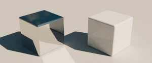

Light Rays was set to 100% using OpenCL, the 2% was only on CPU rendering (which had the correct result).

Just to clarify what the issue is here, the CPU image looks as it should, but the OpenCL image has the shadows much darker. The Light Tracing % was set to 100% for OpenCL, and set to 2% for CPU. I only set it to 2% as I didn't need the default 20% as the caustics would get clear much faster than the rest of the scene
![0001.png (611.58 KiB) Viewed 4211 times OpenCL + Light Tracing (100%) + Caustic Cache](./download/file.php?id=7455&t=1&sid=8280afebccdf2f979665bb313895b96d)
- OpenCL + Light Tracing (100%) + Caustic Cache
![CPU.png (587.98 KiB) Viewed 4211 times CPU + Light Tracing (2%) + Caustic Cache](./download/file.php?id=7456&t=1&sid=8280afebccdf2f979665bb313895b96d)
- CPU + Light Tracing (2%) + Caustic Cache
