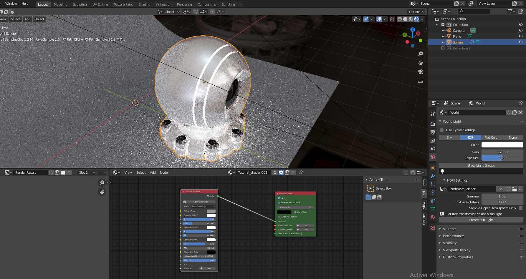

Just look like carpaint shader is broken. It is emissive even in low light condition.
Lux_Shader_Ball.blend
(3.24 MiB) Downloaded 365 times

Yes, using pure 100% white Specular channels can do that.
For reference check Carpaint's Preset: "White" to get to see it physically-based.

Ahh don't even noticed it. but this is not good like this. i mean theses are preset : preset should not be confusing like that. :(
As user you always feel like error come from you. because you're facing preset.

All materials should be energy conserving.. I consider this a bug.
