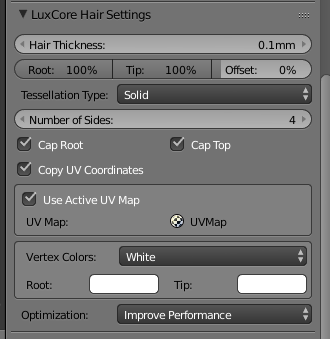

What I've found working best for me is solid hair with number of sides at least 6. There's 4 on picture above though, it's because I don't have enough RAM.

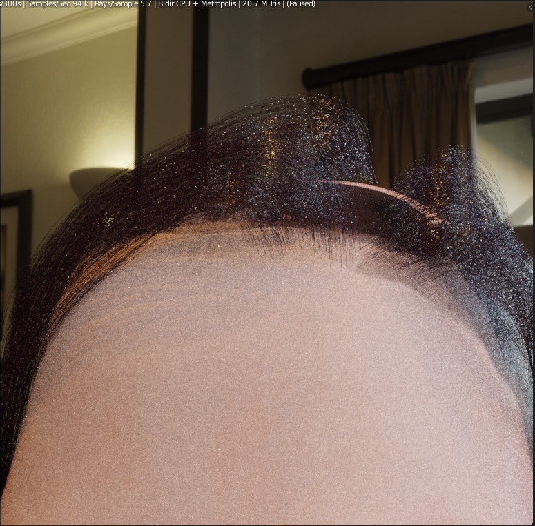

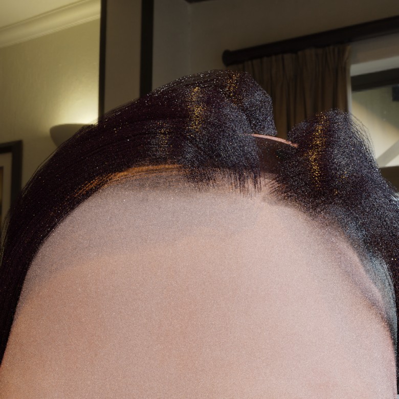

In viewport, hairs are smoothly rendered, but not in real rendering.
Tessellation type is solid with 8 sides.
Blender 2.82
Blendluxcore 2.3RC1
Viewport rendering
Actual rendering

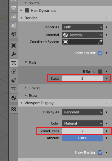

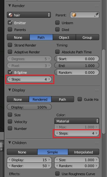

There was similar trouble in 2.79
You had to set both "steps" parameters to equal number to have hair rendered as they are in viewport.
I can't see that another "step" in 2.8 though.
Upd: Found it. Try setting them to equal number.

wasd wrote: Wed Mar 04, 2020 11:59 am
Thanks, wasd.
It works perfectly.
