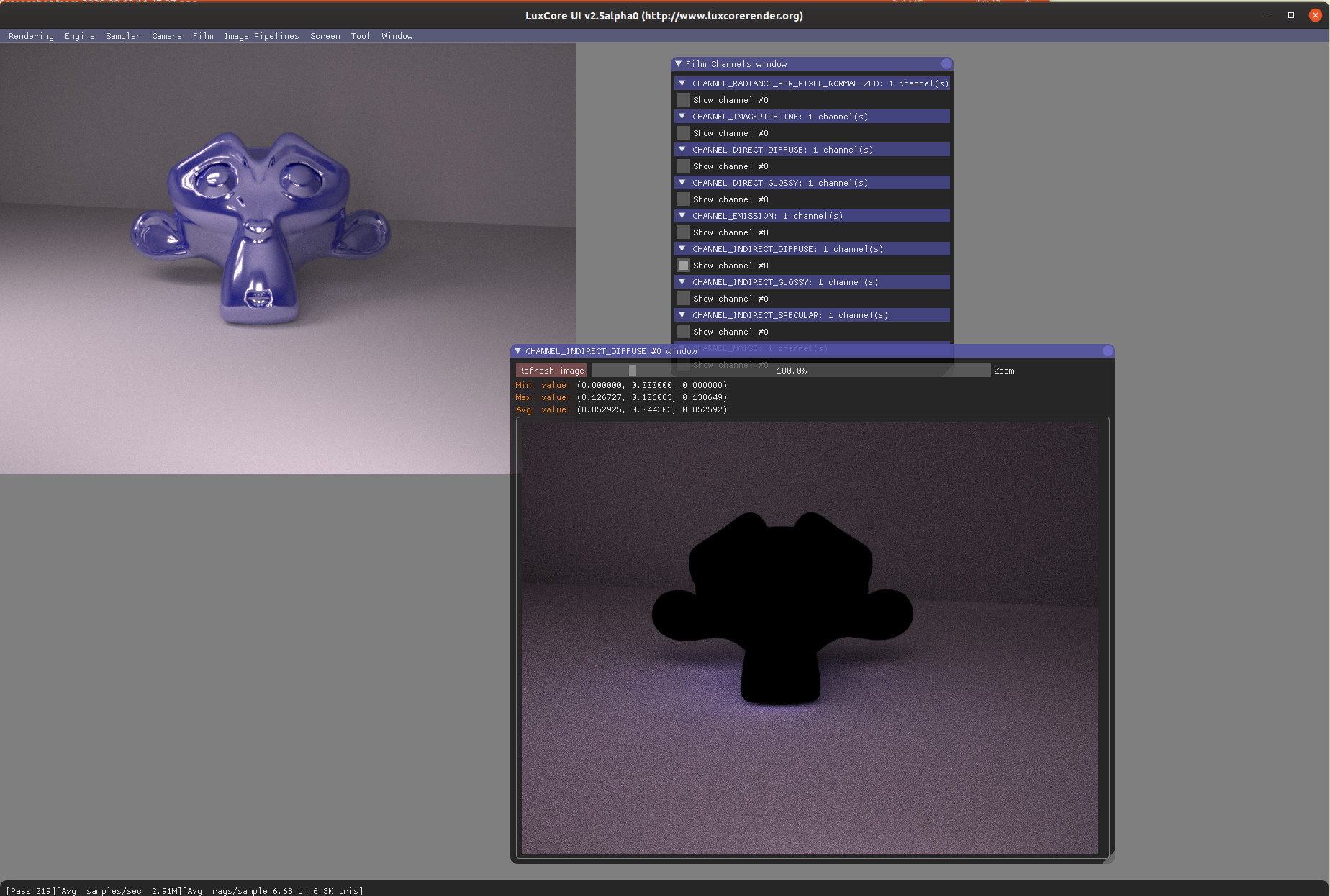

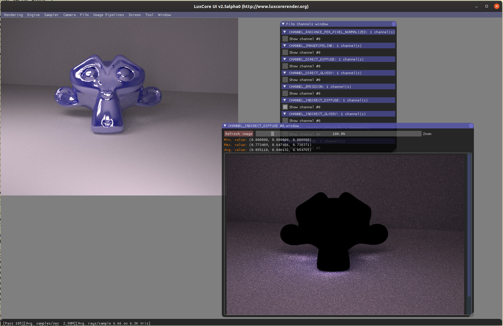

I added the support for AOV clamping for the following AOVS: DIRECT_DIFFUSE, DIRECT_GLOSSY, EMISSION, INDIRECT_DIFFUSE, INDIRECT_GLOSSY and INDIRECT_SPECULAR
This is a INDIRECT_DIFFUSE without clamping:
And this with strong clamping:
