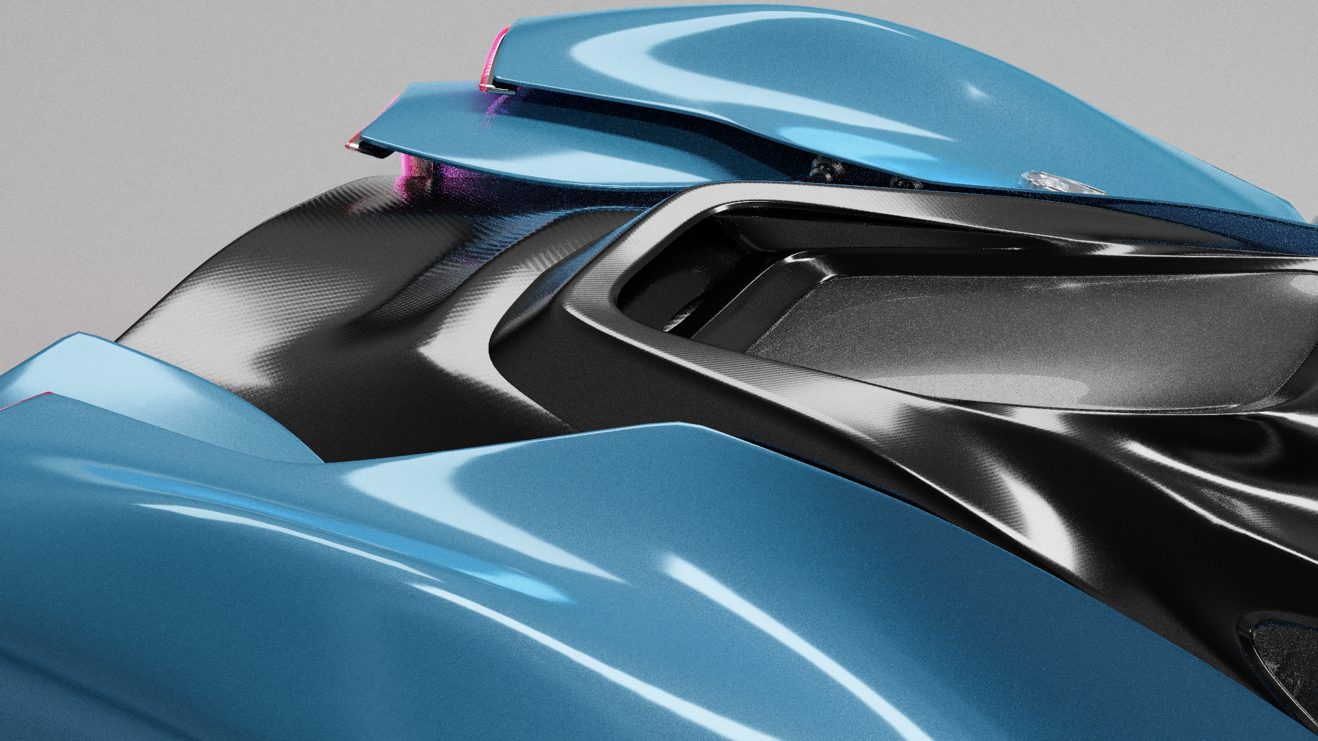

- The first thing that I noticed is that after the denoising process the image kinda looks blurry and some details get lost. I mainly trying to enhance some details like the tire sidewall and the carbon fiber bump textures.
For the image of the BMW with the purple background I used 800 samples, Bi-dir (metropolis) engine, 1,25 px as the filter width and even though the final render is at 1920 x 1080 I rendered it at 2400x1350 to see if the resolution is the cause, but it wasn't. It took 1h 10m to render it. Should I try increasing the samples and deactivate the denoiser? How many samples should I try? Should I consider other parameter to make a sharper image? This kind of blurriness also happens at close-ups. (Image A)
