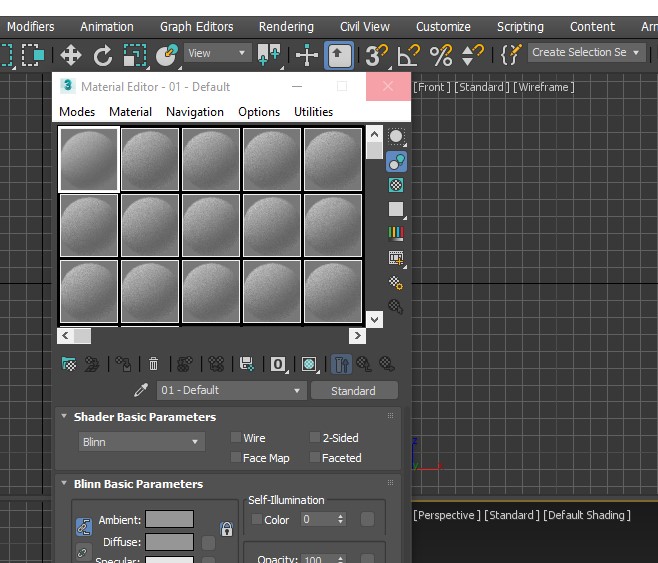

I cant see the problem, it's not crashing for me at all.
a simple scene, complex scene, empty scene, I tried all but nothing happened.
