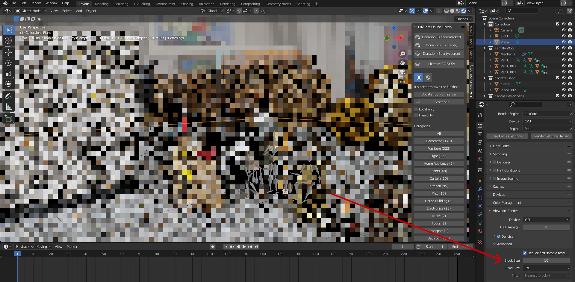

Hi ,
Please where in the code can I found the parameter responssible of the initial block size fading speed ?
(I mean the time it take for the initial large pixel block to disappear )
Re: BlendLuxCore Development
Sharlybg wrote: Fri Jan 21, 2022 10:26 am Please where in the code can I found the parameter responssible of the initial block size fading speed ?
For CPU here: https://github.com/LuxCoreRender/BlendL ... ig.py#L207
For GPU here: https://github.com/LuxCoreRender/BlendL ... ig.py#L231
If I remember correctly, it should already be at the fastest fading speed allowed by LuxCore (in case you wanted to make it fade faster).
To make it fade even faster, you would have to change the LuxCore code, not sure where the relevant part there is located.
Ah this is what I was trying to do make the fading much faster.
Btw is there a part in the code where I can add a time pause
in the viewport render when transformation happen ?
just few millesecond between each viewport update when
change happen.

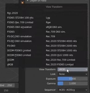

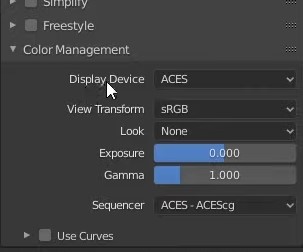

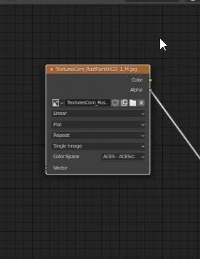

last night I start to add Ocio in the blender and I am still a little bit fuzzy here because I'm not a blender user. sorry if my questions are dumb.
By adding Aces to the blender all these options will be added to the blender and I can read them simply and purse them to luxcore. but I'm not sure if that's the correct way to do it and if I should add Aces/Ocio config to blender like this.
I need a little bit of help here.
That look fantastically correct to me.
Maybe some testing with others artist
And it is good to go.
Congrats btw ;)
Posts: 815
TAO wrote: Sat Feb 12, 2022 2:17 pm last night I start to add Ocio in the blender and I am still a little bit fuzzy here because I'm not a blender user. sorry if my questions are dumb.
Yes, by the looks everything seems alright.
So do you have a demo version or a branch somewhere ready for testing?
