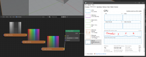

Dade wrote: Mon Feb 08, 2021 5:05 pm I'm guessing Cycles stores RGB (i.e. 3 channels images) as 4 channels, wasting a 33% of GPU memory. Can someone confirm this ? It shouldn't be hard to test by using a very large texture map with 3 or 4 channels and checking the amount of GPU memory used: if the amount is the same, my theory is confirmed.
I did a test with the following scene:
Render on GPU only (CUDA) with Cycles.
Three versions of a 16000x16000 pixel image: 1 channel (black/white), 3 channels (RGB), 4 channels (RGBA).
Output resolution 100x100.
I have no precise measurements of the used GPU RAM, but the task manager graph shows that your suspicion is probably right, as there's no difference in memory usage between 3 and 4 channel images.
Re: BlendLuxCore Development
Maybe if you try the same test in a bigger image size the difference can be more obvious.
The memory usage for the compare part is so small that hardly can be noticed.
