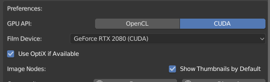

The BlendLuxCore Preferences and the viewport render kernel precalculations only show CUDA, no OptiX. Is OptiX being used yet?
If you have the CUDA backend selected, there should be an OptiX option. If it's not there, you might not have a correct 2.5 installation? Try to delete the whole addon folder and do a fresh install of the daily build.
The user preferences should look like this:

Ah, thanks! I had overlooked the OptiX checkbox.
