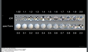

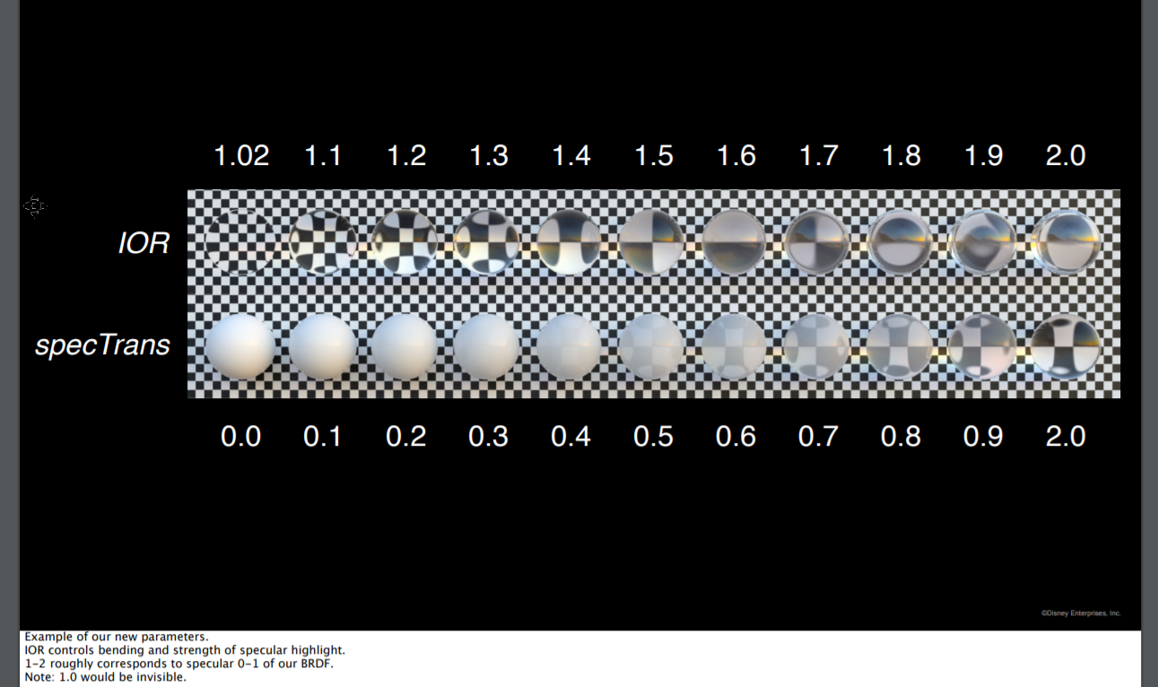

I just want to be sure that I understand it correctly: in Disney, we don't make real transmission/subsurface scattering, we just fake it according to empirical laws?
I just wonder about this https://blog.selfshadow.com/publication ... slides.pdf (page 20). Is it just a combination with "real" refraction?
I guess, I'm ok with the code of BSDF Specular Transmission and it plugs easily into the current Disney implementation.

The first version of the Disney material proposed in SIGGRAPH 2012 paper hadn't a specular transmission component at all. 2012 it is what is currently implemented in LuxCore. The specular transmission support was than introduced in a successive 2015 SIGGRAPH course. We just need to add the 2015 new stuff to LuxCore too.chuchur wrote: Wed Jun 30, 2021 8:50 am I just want to be sure that I understand it correctly: in Disney, we don't make real transmission/subsurface scattering, we just fake it according to empirical laws?
About SSS, 2012 has a very simple faked SSS on the edge of objects. As far as I remember the 2015 introduced a more complex faked/approximated SSS however it has a very long list of problems and I don't think it makes any sense in the LuxCore context. So I would keep the 2015 SSS support out of the picture for the moment.
I'm not sure to understand the question but, yes, it is just a real (optional) refraction component.chuchur wrote: Wed Jun 30, 2021 8:50 am I just wonder about this https://blog.selfshadow.com/publication ... slides.pdf (page 20). Is it just a combination with "real" refraction?
Yes, it is about adding one more optional component to the current Disney material.chuchur wrote: Wed Jun 30, 2021 8:50 am I guess, I'm ok with the code of BSDF Specular Transmission and it plugs easily into the current Disney implementation.

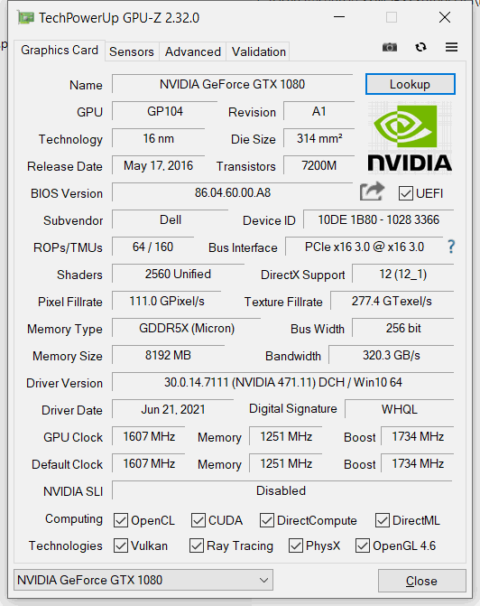

in Cudadevice.cpp lines 41-43 cuda minor and major versions are defined.
I have minor 1 and major 6 on my machine, so useOptix is false in my case.
I've forced useOptix to true and looks like it works (at least Optix gets initialized and I can render proper images).
https://github.com/LuxCoreRender/LuxCor ... ce.cpp#L41
I have Optix 7.3.0, cuda v11.3.
const int major = GetCUDAComputeCapabilityMajor();
const int minor = GetCUDAComputeCapabilityMinor();
useOptix = (isOptixAvilable && ((major > 7) || ((major == 7) && (minor == 5)))) ? true : false;

In our tests, Optix is, sometime, very slow on no-RTX hardware. I assume is just programmed obsolescence by NVIDIA: my BVH code is faster on 9xx/10xx GTX card so this is the reason of the default setting.chuchur wrote: Thu Jul 15, 2021 8:42 am in Cudadevice.cpp lines 41-43 cuda minor and major versions are defined.
