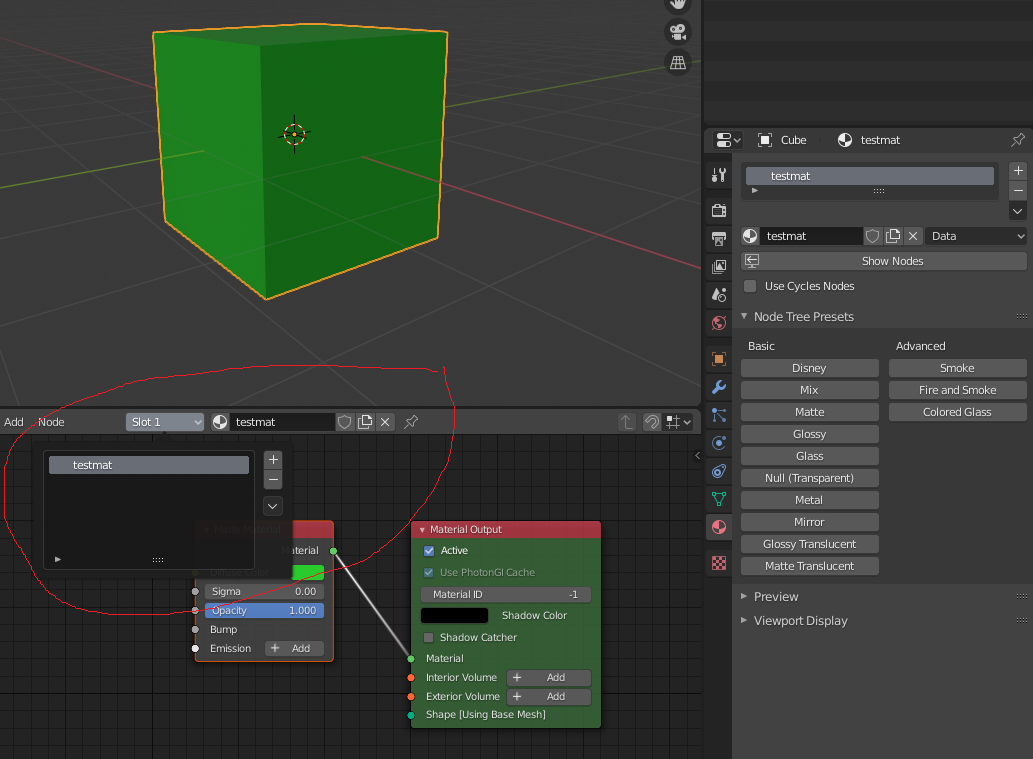

I found a way to create a custom UI for the LuxCore material node editor header, so it shows the material name/controls instead of the node tree name, like in Cycles.
