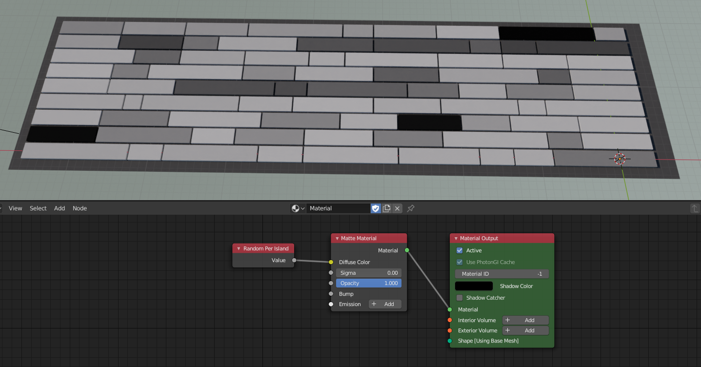

I have added support for the "random per island" node to the Blender addon:

B.Y.O.B. wrote: Sat Mar 28, 2020 11:59 am I have added support for the "random per island" node to the Blender addon:
thanks mate.
just wonder how the node look with a texture map as input :?:
Re: BlendLuxCore Development
Sharlybg wrote: Sat Mar 28, 2020 12:33 pm just wonder how the node look with a texture map as input
Not sure what you mean?
You get a random float value between 0 and 1, and you can use this in other nodes.
For example to drive the hue of a HSV node to generate colors, or as input for a color ramp, or in a color mix, etc.

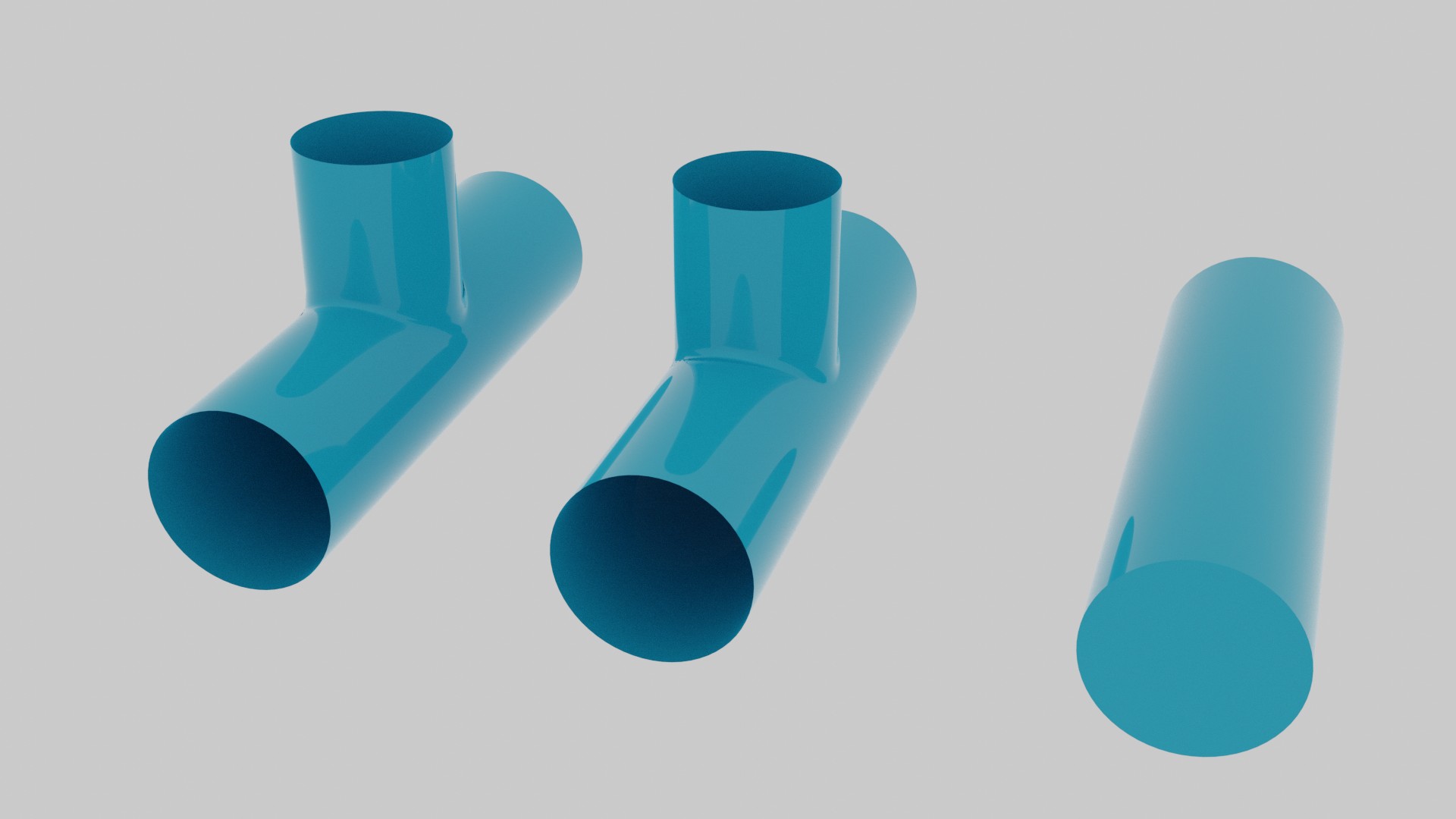

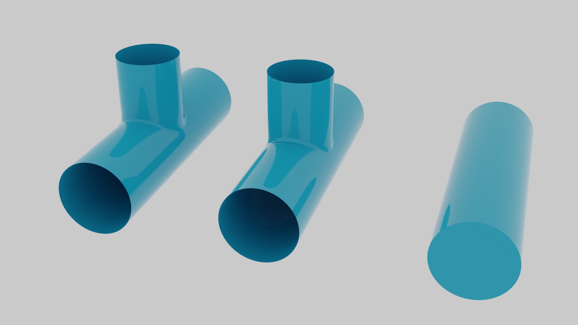

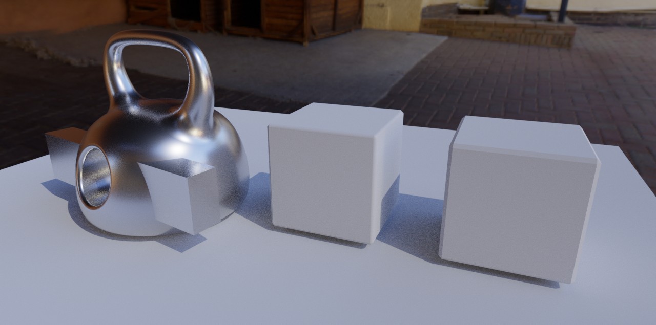

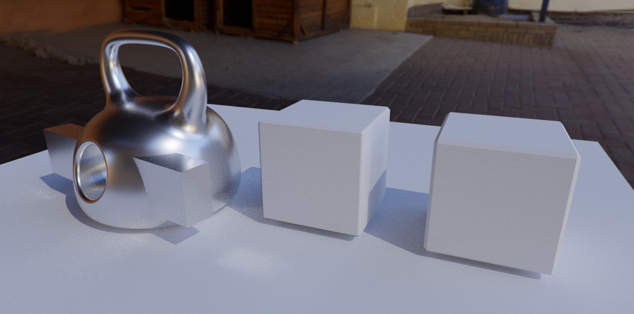

BlendLuxCore now supports custom split normals.
cycles
cycles
lux
lux
cycles
cycles
lux
lux

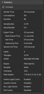

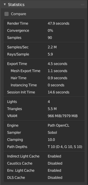

I added some new statistics, hopefully useful:
- mesh export time
- hair export time
- instancing time
- info about caches (enabled/disabled)
