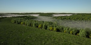

From practical point of view if we want to create a fog effect in the scene (one type of fog for the entire scene) we have to follow those simple steps.
1. Create a box that will enclose the entire scene because we don’t want to have infinite volume. Then assign volume to that box:
2. Now we have to understand if we have to assign volume to the camera. We assign volume to the camera ONLY if the camera is inside the volume.
3. We assign volume to all light sources that are inside fog. Sun and environment are always outside volume so we do not change it.
or if we are using geometrical lights:
If I made any mistake, please correct.
scene.materials.fogVolume_material.type = "null"
scene.materials.fogVolume_material.volume.interior = "fogVolume"
scene.camera.autovolume.enable = 0
scene.camera.volume = "fogVolume"
scene.lights.lightName.volume = "fogVolume"
scene.materials.emmitter_material.volume.interior = "fogVolume"
scene.materials.emmitter_material.volume.exterior = "fogVolume"
