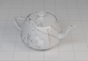

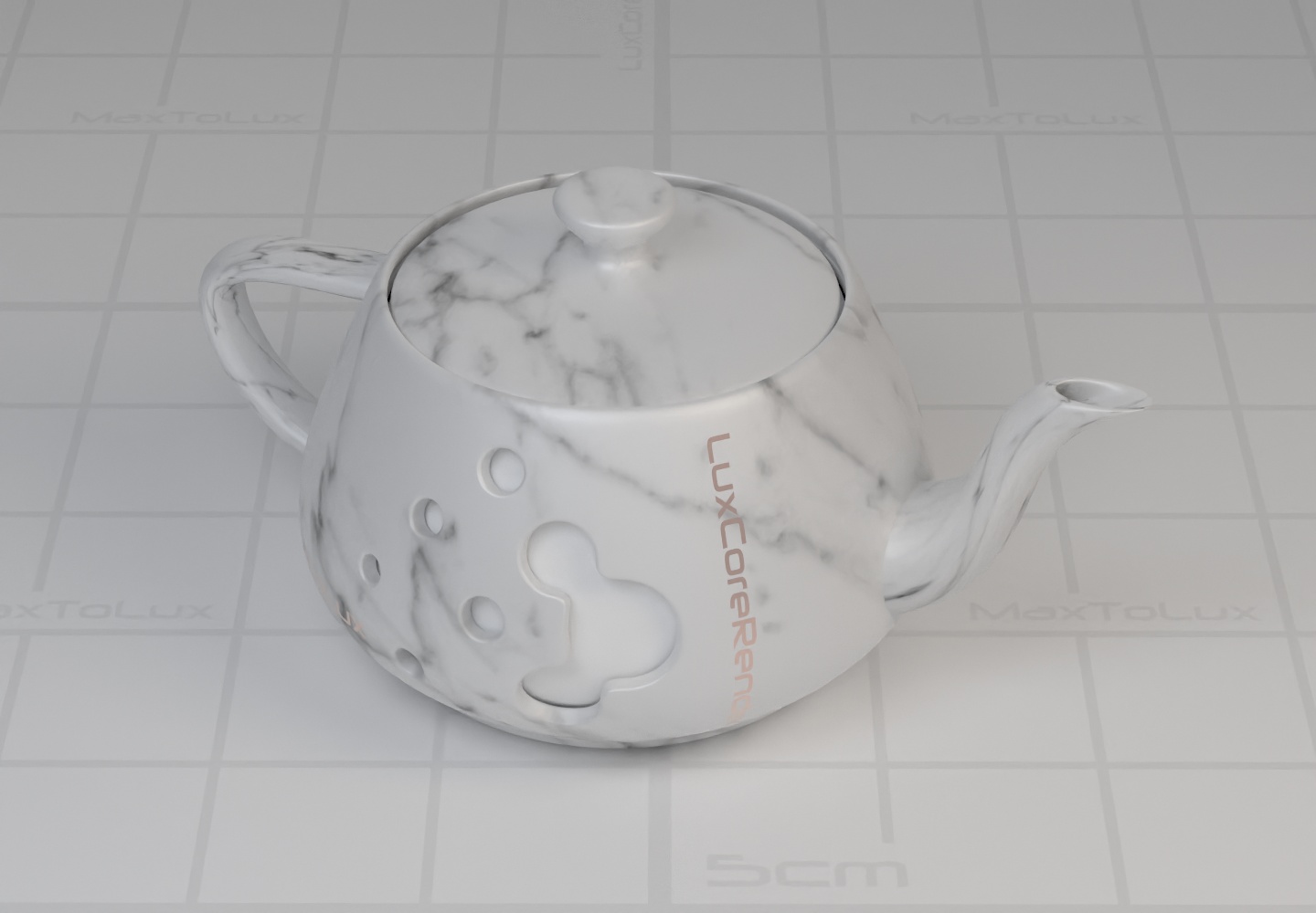

This is the final LuxTeapot archived as max 2018 version.
I tried to make it smaller, TAO tried too, but so far we didn't succeed.
I'm a noob in modelling in 3ds Max and the LuxTeapot is modeled in Rhinoceros 7
LUxTeapot.zip
(3.64 MiB) Downloaded 607 times

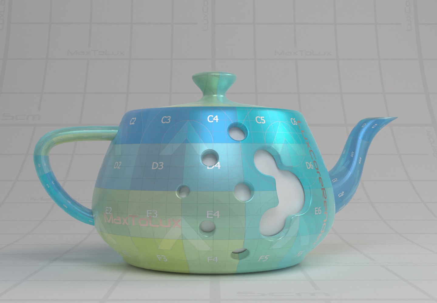

changes:
- LuxTeapot and soup are the only body objects geometries. They are saved as coarse, Have a look at "important see me.jpg" to get them smooth in render. So, do not apply turbosmooth or OpenSubdivis or similar modifier because it won't help.
- Soup is scaled down to 99% If you want to do a test like a glass of juice scale the soup to 101% to get overlapping.
- the Lid to be rendered by the Blender_PhysCam needs that lathe modifier has segments set to 32 or with turbosmooth interaction 2.
- better MaxToLux and LuxCoreRender text.
- 2 cameras each has its own base plane which is aligned with the camera view. See "set" layer content to turn on/off by need and See attached images for the difference.
- the texture tiling on the base planes are optimised to repeat 4 times. 5cm square X 20 = 1mt (sometimes my 3ds max doesn't save changes i make for tiling)
- all textures visible in the renders are included.
NOTE: LuxTeapot for correct mapping needs to have Unwrap UVW, or Edit Poly/Mesh applied so that UVW Map modifer applied on top can work at render time.
TAO opened https://github.com/LuxCoreRender/MaxToLux/issues/70 once implemented it should avoid in future the need for Unwrap UVW modifier to be applied, Which will makes it possible to render LuxTeapot with just "medium" setting selected instead of "fine". Which should result in faster rendering.

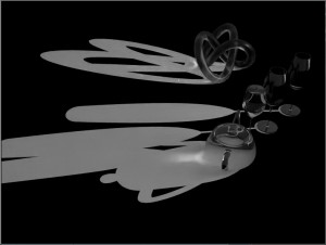

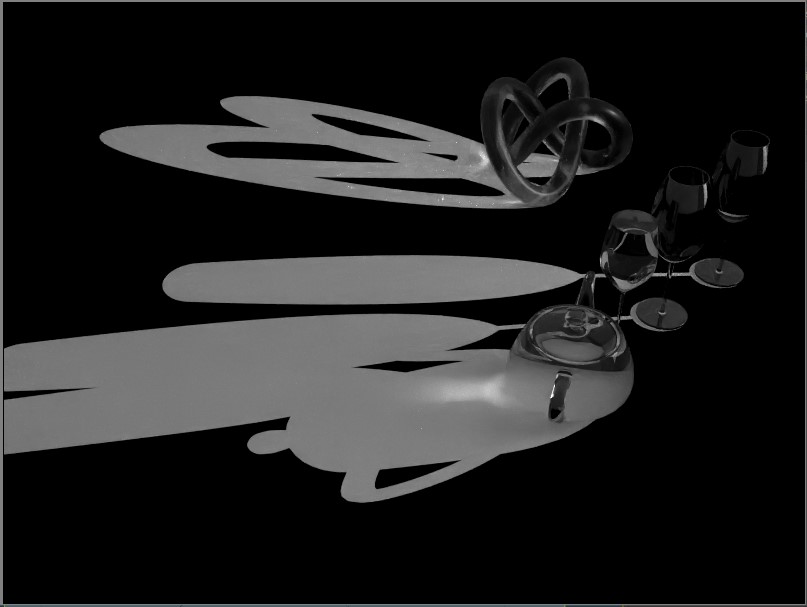

Add shadow catcher option.

TAO wrote: Wed May 05, 2021 5:26 pm Add shadow catcher option.
I want to try it with camera match!!
