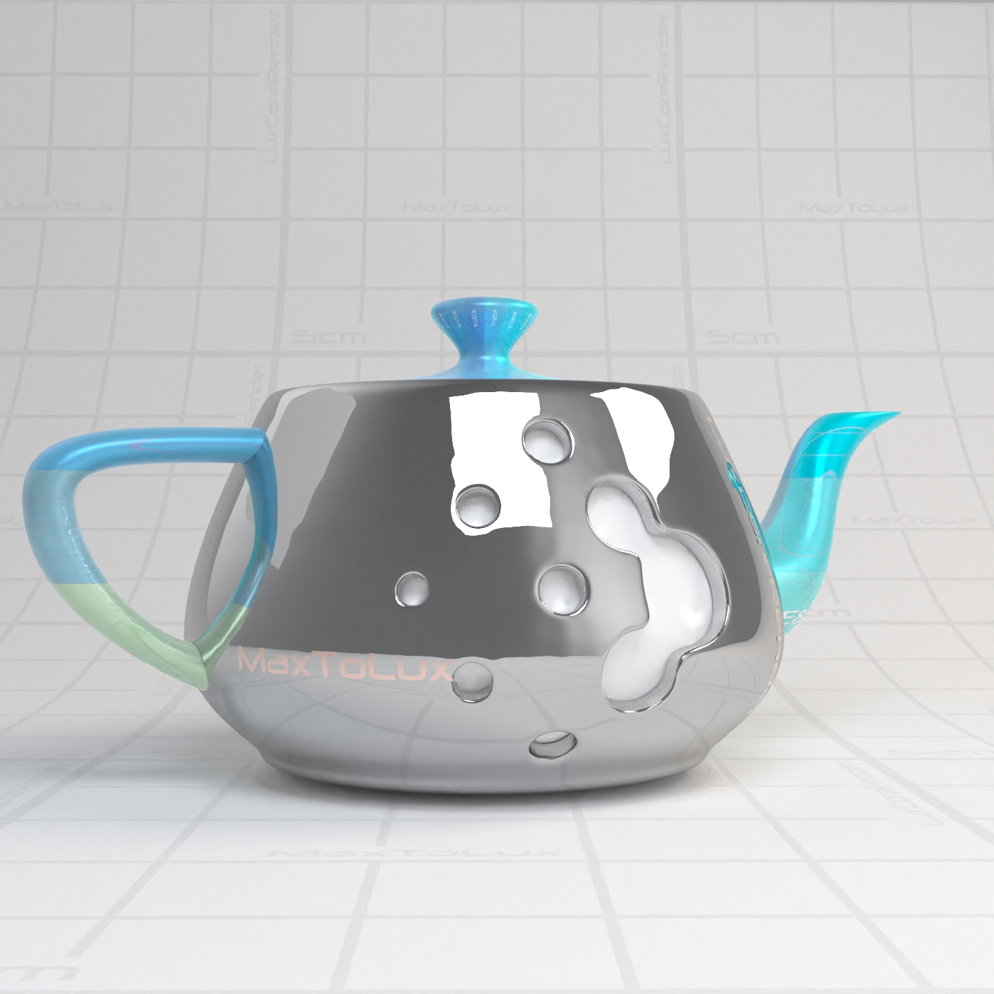

Thank you for your effort.
This pic is the render of the teapot you posted.
I think that the body object option is still the best option.
Reflection and smoothness of the surface are almost perfect in the body object version, when geometry is set to fine as shown.
Of course it is a bit bigger in size, but it renders fast anyway.

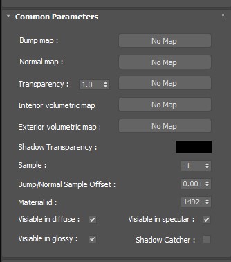

Add missing material parameters :
Shadow transparency and color
Bump offset sample
shadow catcher

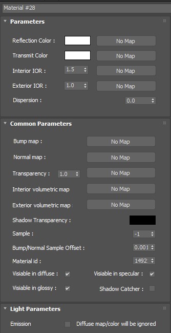

Also, Dispersion for glass.

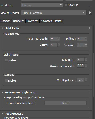

Adding LightPaths Tracing Options.
Total Depth options
Diffuse depth
specular depth
glossy depth
light rays
glossiness
clamping

TAO wrote: Thu Apr 29, 2021 10:23 pm Adding LightPaths Tracing Options.
Total Depth options
Diffuse depth
specular depth
glossy depth
light rays
glossiness
clamping
Great. That's exactly what was missing for glass and caustic right? that's why i did not get the good result with caustics!
