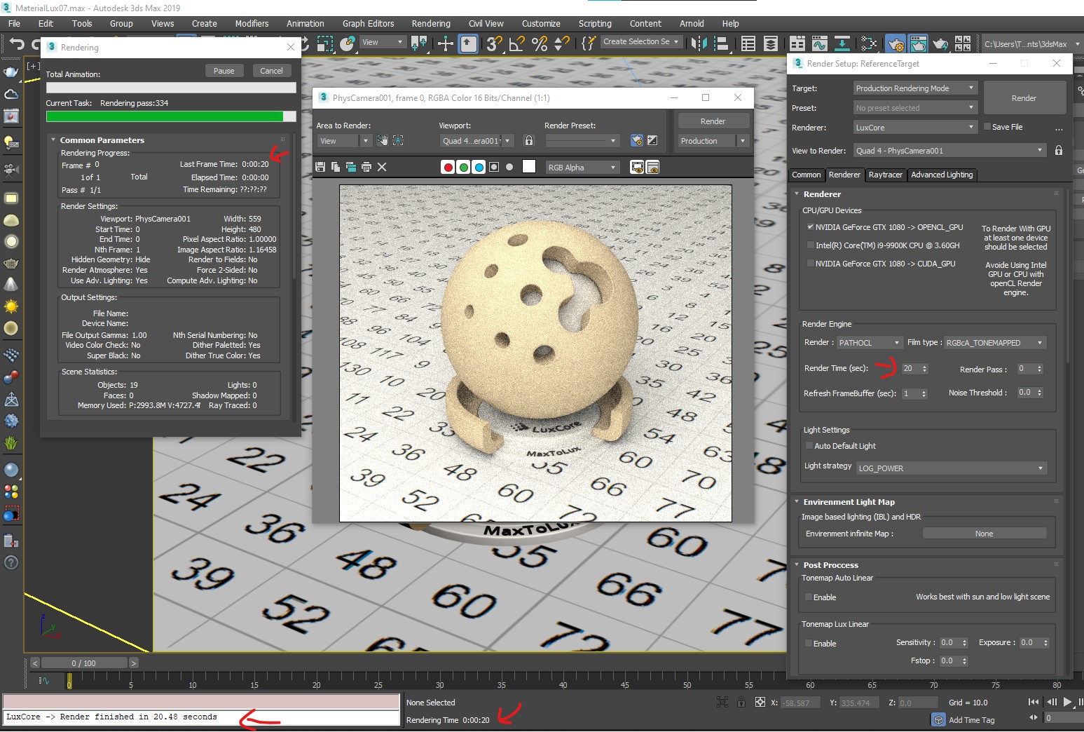

Add more information about the render time in case the render cancel by the user.
greatTAO wrote: Thu Apr 15, 2021 3:12 pm Add more information about the render time in case the render cancel by the user.

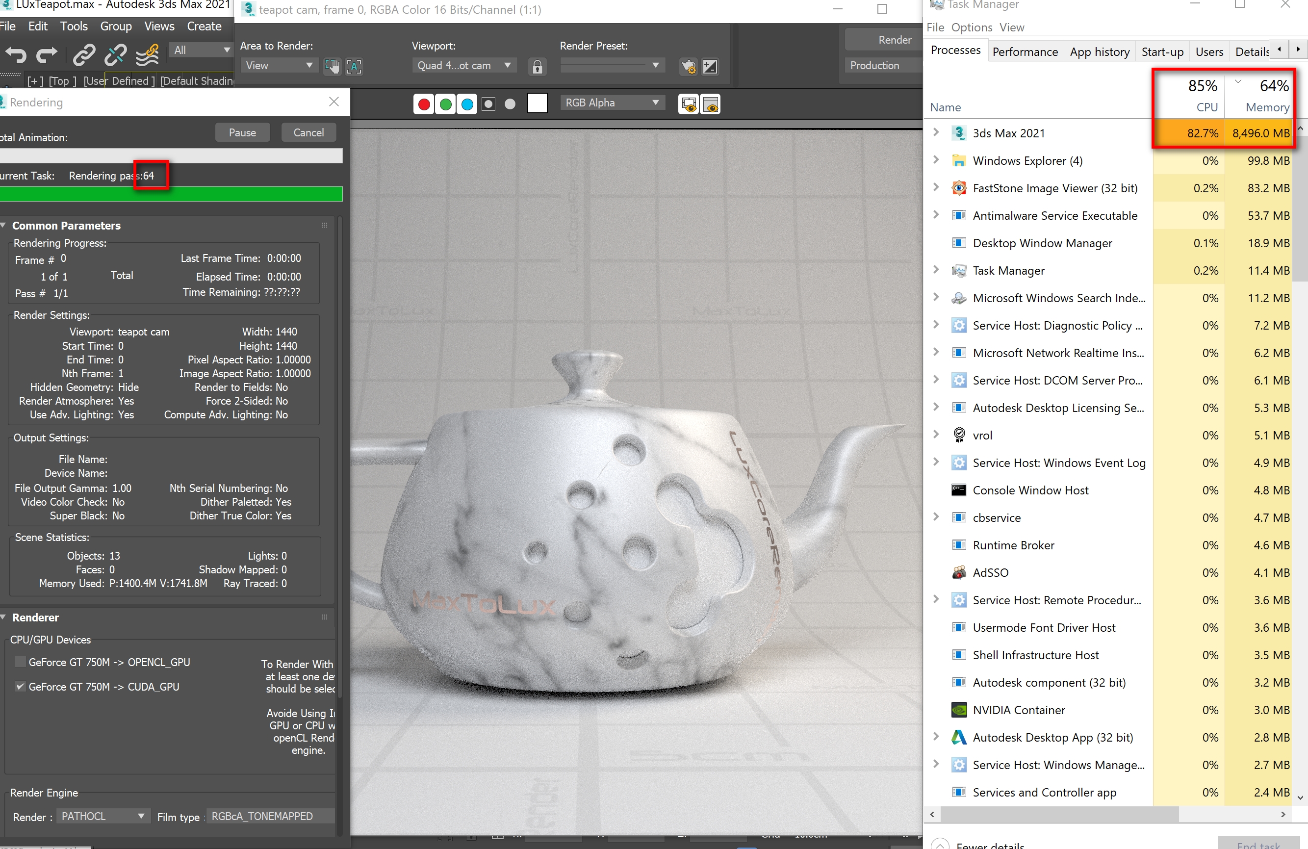

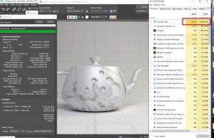

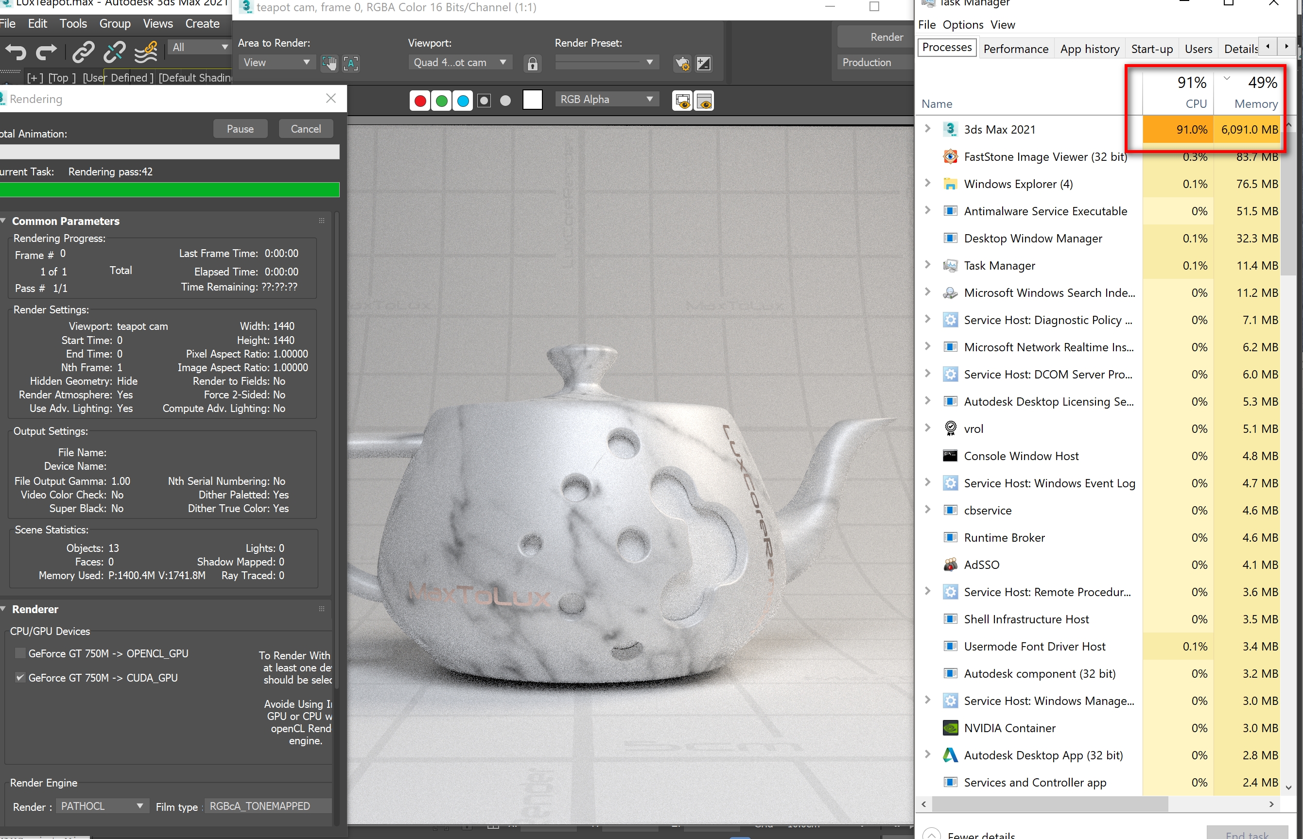

I rendered the same scene with maxtolux 8.2.7 and with 8.7.9 and it is showing a memory problem.
see attached screen shots.
first is made with maxtolux 8.2.7 ram usage is constantly floating to max usage of 1.543... shoiwing pass 39, but it can run for 600 passes more and by stable ram usage. the other 2 screen are made with new 8.7.9 taken at pass 42 and at 64 as you see the Ram is increasing by the time.. it will reach 13GB /14GB by about 100 passes
Already fixed, just install the new version.patro wrote: Fri Apr 16, 2021 3:17 pm I rendered the same scene with maxtolux 8.2.7 and with 8.7.9 and it is showing a memory problem.

Works great here, thank you.
