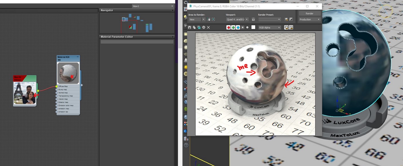

I double checked the UV settings and that's the result:
If this is the correct result you expect let me know.
@Patro, Is that what you report for fliped images with correct UV?If this is the correct result you expect let me know.
TAO, do you refer to thisTAO wrote: Mon Apr 12, 2021 7:40 pm I double checked the UV settings and that's the result:
from the image you posted, it looks like the bitmap on the luxball is rendered correctly, Looking on your photo and on the rendered luxball, your wife is on your left.When using a bitmap map to texture a material, the used bitmap is rendered mirrored if the geometry has no UVW Map modifier applied.
My wife is on the right side that's me on the left side. I should use a better quality image.patro wrote: Mon Apr 12, 2021 8:59 pmTAO, do you refer to thisTAO wrote: Mon Apr 12, 2021 7:40 pm I double checked the UV settings and that's the result:
If this is the correct result you expect let me know.from the image you posted, it looks like the bitmap on the luxball is rendered correctly, Looking on your photo and on the rendered luxball, your wife is on your left.When using a bitmap map to texture a material, the used bitmap is rendered mirrored if the geometry has no UVW Map modifier applied.
no need for a better bitmap, it is clearly working correctly now, and of course without uvw map modifier.TAO wrote: Mon Apr 12, 2021 11:37 pmMy wife is on the right side that's me on the left side. I should use a better quality image.patro wrote: Mon Apr 12, 2021 8:59 pmTAO, do you refer to thisTAO wrote: Mon Apr 12, 2021 7:40 pm I double checked the UV settings and that's the result:
If the output of the bitmap would be flipped in the rendered image you would be shown on the right and your wife on the left.
