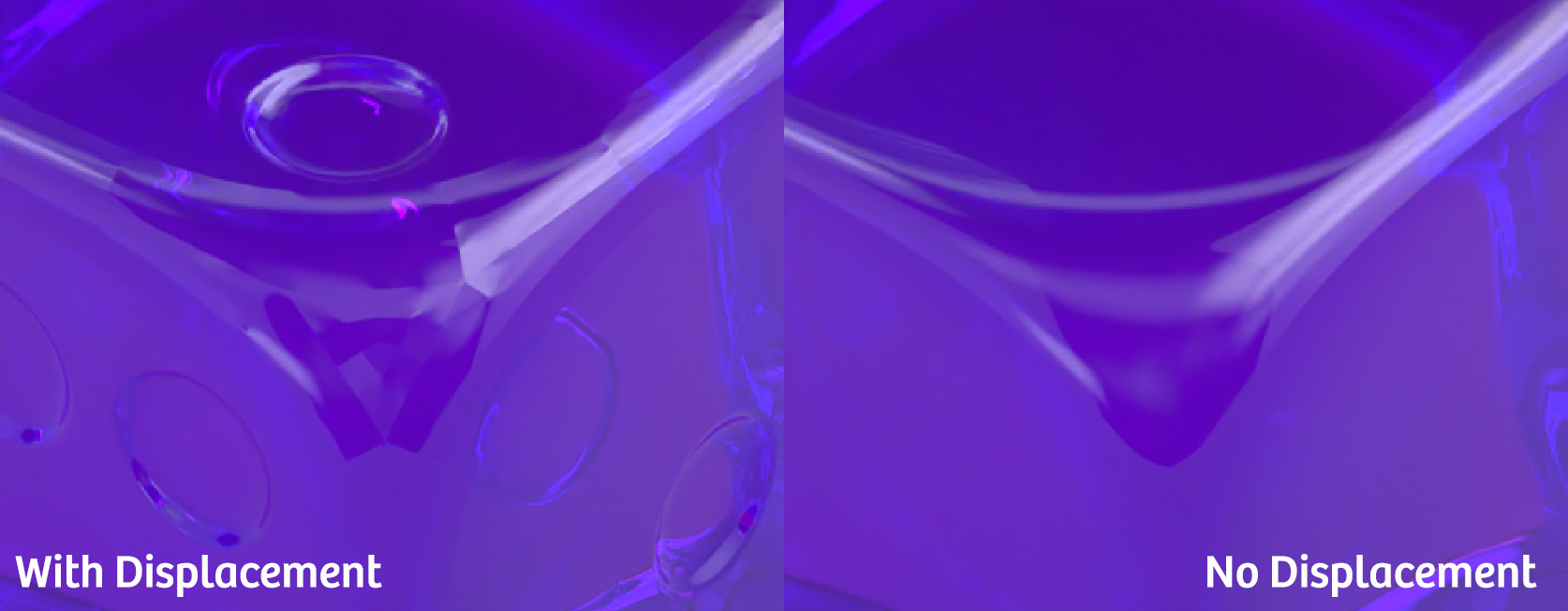

When using the Subdivision node in combination with the Height Displacement node - is there a way to keep the smooth shading of the surface?

Some information about this issue as well?AndreasResch wrote: Thu Mar 25, 2021 6:03 am When using the Subdivision node in combination with the Height Displacement node - is there a way to keep the smooth shading of the surface?
Re: (Open)Subdiv and Displacement shapes
Smooth shading is preservedAndreasResch wrote: Thu Mar 25, 2021 10:22 amSome information about this issue as well?AndreasResch wrote: Thu Mar 25, 2021 6:03 am When using the Subdivision node in combination with the Height Displacement node - is there a way to keep the smooth shading of the surface?

Here's a comparison with and without displacement.
