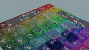

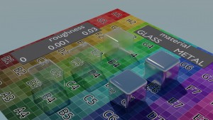

Martini wrote: Mon Aug 23, 2021 4:22 pm From what I can guess/observe by looking at the render result, it looks like the transmission is not present in the rough glass, and perhaps the normals are a bit weird also.
Looks like roughglass is working spectacularly well in latest build (sorry for not testing for a few days) :D
LuxCore roughglass
LuxCore roughglass
Thanks Dade
