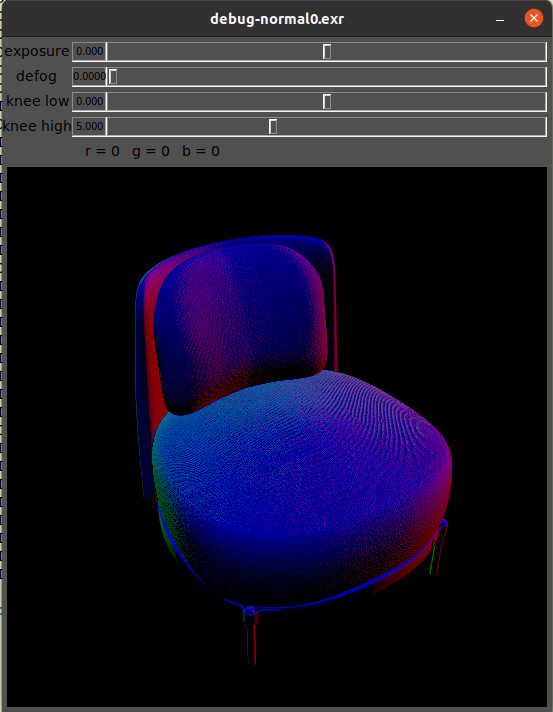

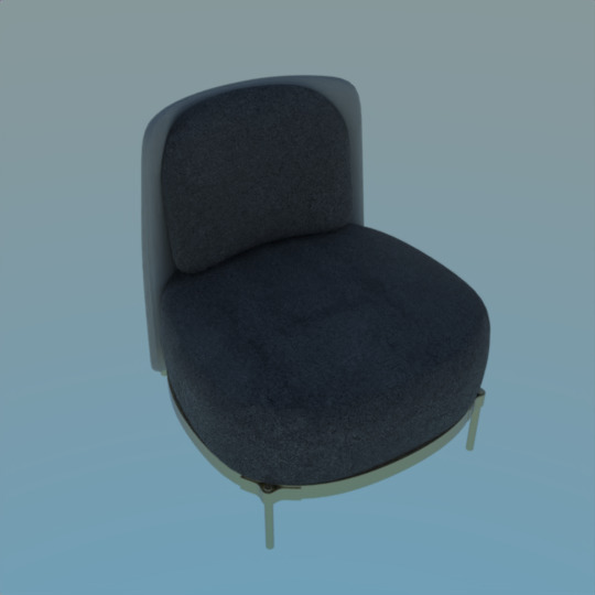

Ok, this is what I found.
This is a rendering with 100 spp:
There is clearly a filtering problem (i.e. the moire effect).
Even more samples per pixel will not help, this is a 1000 spp rendering:
However, if I re-enable pixel filtering (note: disabled because of OIDN requirement), even a 100 spp rendering is a lot better:
So I tried to just use ODIN with pixel filter enabled and the result looks a lot better. This is a 100spp rendering (first is raw, second is denoised without pixel filtering, the latest is denoised with pixel filtering):
I would say that latest is a far better denoised result. We clearly need to have pixel filtering enabled, at least on Normal pass.
Unfortunately, because the why pixel filtering works, I can not conditional filtering on some AOV and not on others (I would have to literally render the image multiple times).
At the moment, my conclusion is that we should re-enable pixel filtering for path tracing + ODIN. BiDir should probably stay like it is because, I'm pretty sure, the way pixel filtering work in BiDir will drive OIDN crazy.
