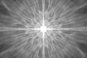

I can reproduce the problem with a simple test scene, only 1 lens, detector, and a laser light source that produces as focus spot.
In this simple scene, the focus spot grows gradually with increasing x-direction, and becomes vertically/horizontally striped in y/z-direction.
It is a bit worse with BiDir than with Light tracing. It has to be considered also that laser is effectively a point source so the spot I'm observing in the simple scene is really small.
So I would think this is some numerical precision issue. Not sure if this can be overcome, that would be a question for Dade.
In your scene with more complex setup, it somehow appears more sudden, at distances of 4m and then gets worse. Also, you are using multiple lenses , which might amplify the issue.
Side note: You can also start seeing the tesselation of the lens. Makes for some good abstract art though. Behold the holy floating-point :D

I have been thinking a bit more. It makes sense that this happens. (Real) lens surfaces need to be shaped and polished very accurately for good optical performance. Kind of why made this addon in the first place ;)
So it makes a difference whether a vertex coordinate is 1.001 or 1.002. If you offset everything, e.g. to 61.001 = 6.1001e1, you have increased one digit of precision.
What we're observing seems to be consistent with 32-bit float accuracy, at least in terms of when significant changes to a lens mesh start to be visible, can't manually confirm a ray-traced image.
