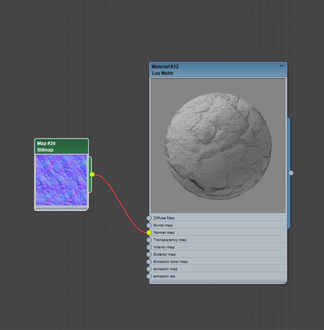

For a simple bump, just use the bump node.
same for the simple normal bump.
