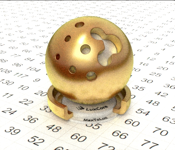

about the car paint. can you post the setting for this gold?
I'm not carpaint expert here but if you have a darker fresnel color reflection should go higher.
Look at the sample scene that I'm trying to create for tomorrow.
Tomorrow i will add light material again and Also, upload a few scenes that help with laser, fog, Carpaint.
If i have enough time i will add the default value for Carpaint material too.
Yes, carpaint is a nice material, needs a bit of knowledge and experimenting with it.TAO wrote: Wed Feb 17, 2021 11:43 pmI'm not carpaint expert here but if you have a darker fresnel color reflection should go higher.

Yes, but I removed a few options and support for other material, because of the conflict with Vray. I already add it again so any material can be used as light material.patro wrote: Thu Feb 18, 2021 8:49 amYes, carpaint is a nice material, needs a bit of knowledge and experimenting with it.TAO wrote: Wed Feb 17, 2021 11:43 pmI'm not carpaint expert here but if you have a darker fresnel color reflection should go higher.
