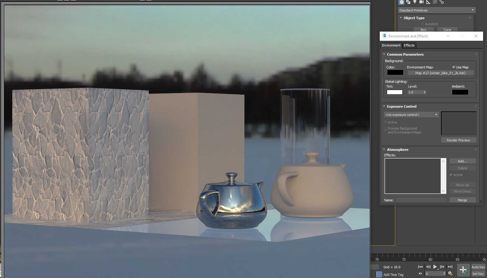

In the meanwhile, I add support for the environment map and IBL lighting that can be used in the upcoming build.
Posted: Sun Feb 07, 2021 12:25 am
by patro
Looks very sweet with ibl lighting :) I'll test it. Thank you.
