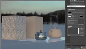

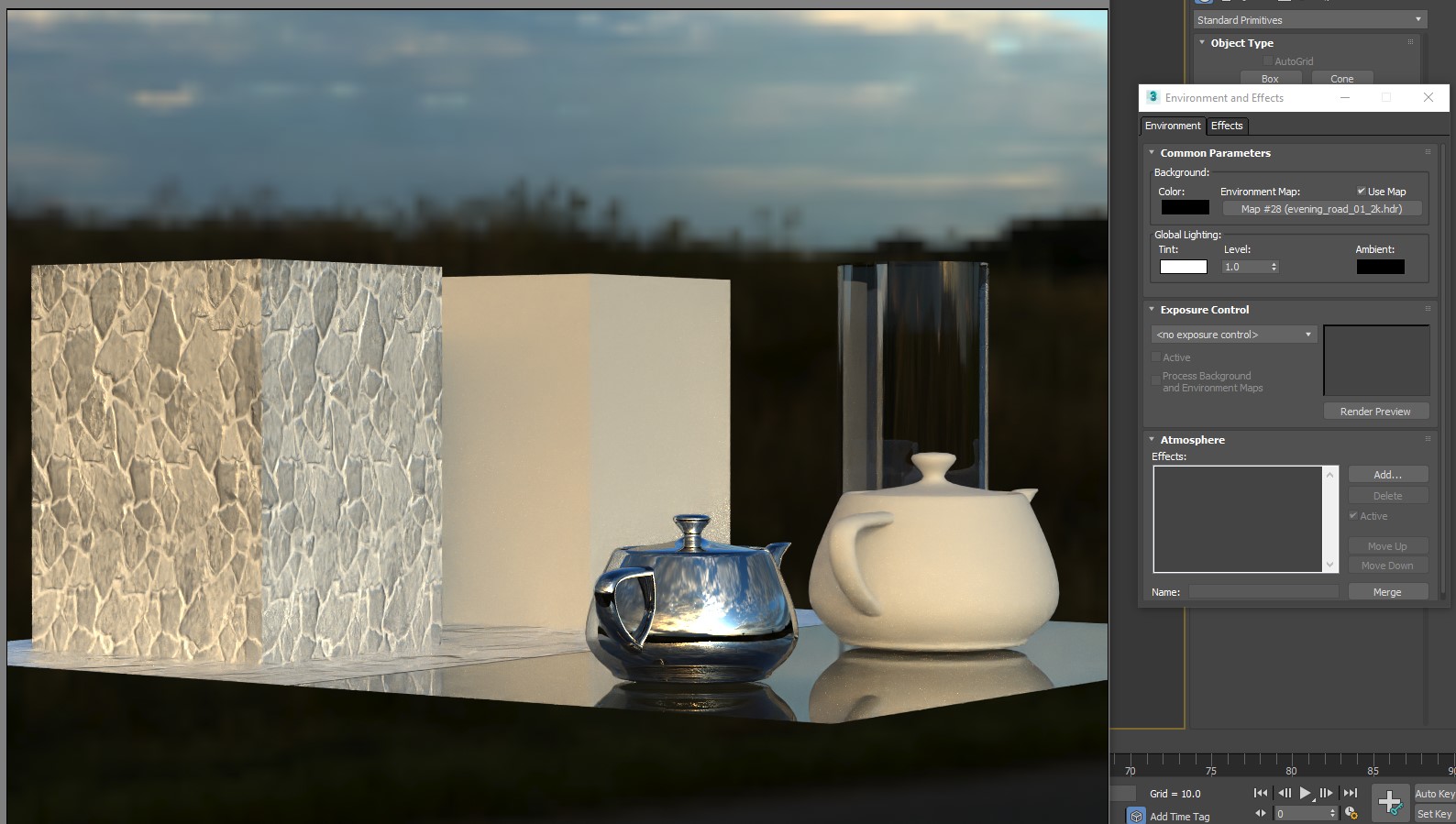

In the meanwhile, I add support for the environment map and IBL lighting that can be used in the upcoming build.
Looks very sweet with ibl lighting
I'll test it. Thank you.
