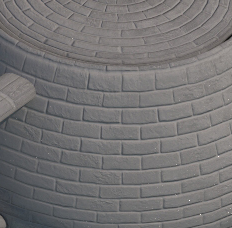

As Dade mention, 3dsmax scenes are way big compare to what we see in almost all other software, so I add a method to match 3dsmax scenes in the metric systems to other software like blender.
It works for LuxCore too and has a huge impact on the render results.
The Old scene with no scale match.
The new one in the metric system with scene match.
now every scene should be scale as LuxCore expected.
In addition, I add two parameters for the usual scene that does not in the metric system unit.
scene.epsilon.min = 0.01
scene.epsilon.max = 0.1
it's a bit different from the scale size match but work perfectly with adding a little bit of extra time to render.
