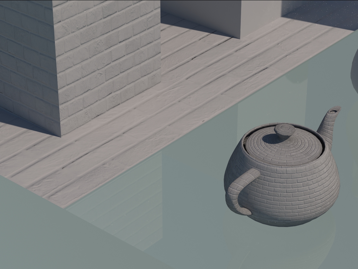

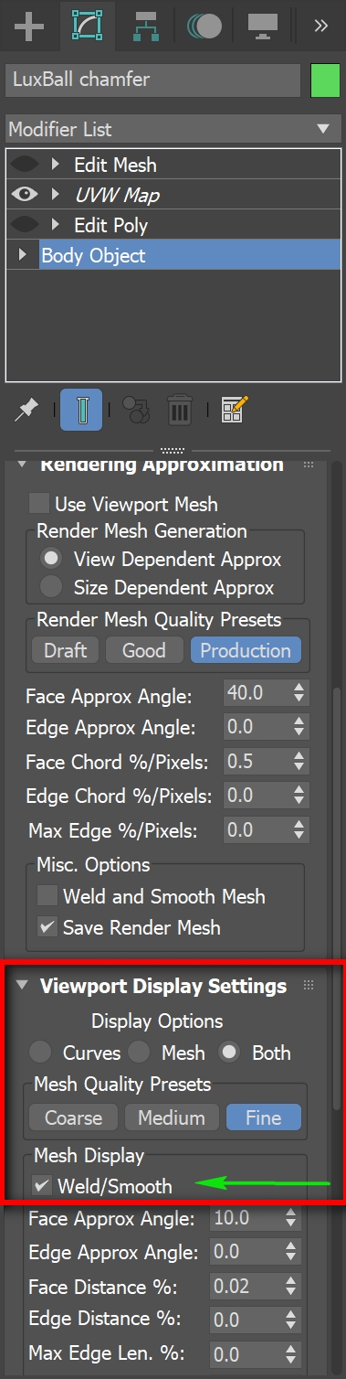

Hi TAO, the cut edge is gone. To do so there is a setting to flag. see attachment

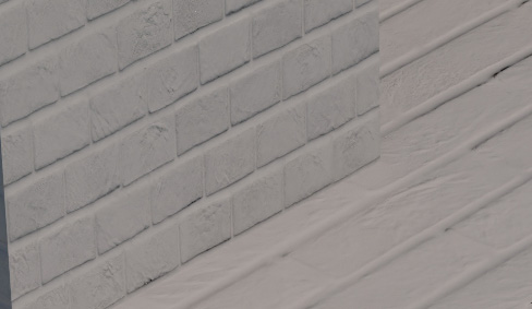

But the strange deformation of the reflected lights and metric grid is not all gone, right near the cutted holes you will notice a deviation of the grid lines from its natural path. Strange that it doesn't happen with vray.
I think the luxCore behavior is normal but I don't know why is not happening with Vray.
I need to check that, maybe, they are welding close vertexes on the translation process.

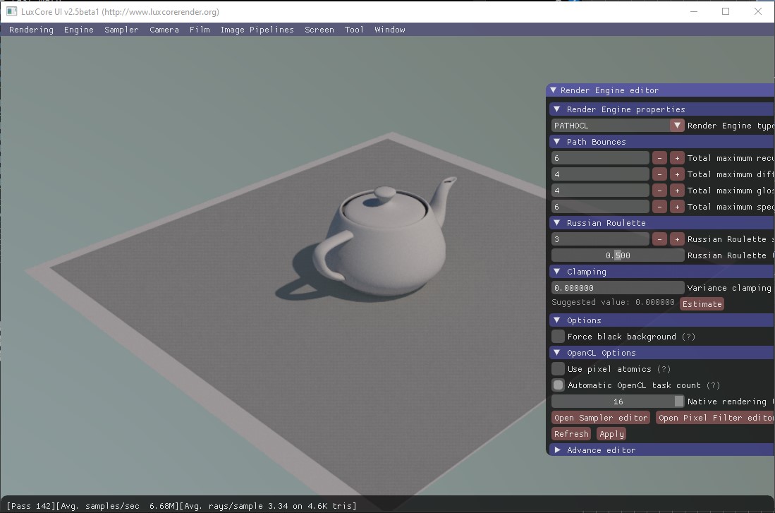

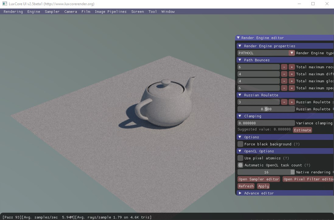

The Old scene with no scale match.
The new one in the metric system with scene match.
now every scene should be scale as LuxCore expected.
In addition, I add two parameters for the usual scene that does not in the metric system unit.
scene.epsilon.min = 0.01
scene.epsilon.max = 0.1
it's a bit different from the scale size match but work perfectly with adding a little bit of extra time to render.

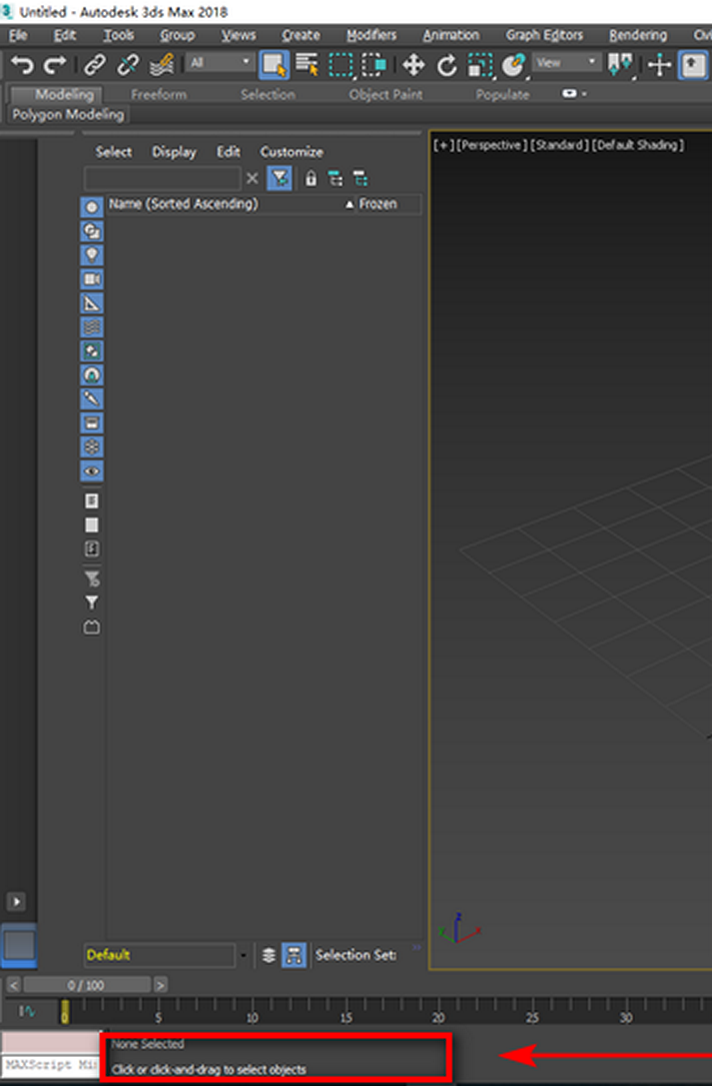

yes, or maybe as renderers does in 3ds max, in the lower left corner of the 3ds max UI, this information is available after rendering end.
Vray does deliver this information too in the same way,
Good idea, I'll try to add it in the next build.
