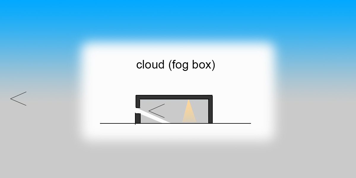

Let me explain. I'm looking for a solution that makes the user experience identical to the real thing.
Imagine a cloud (fog box). Inside the cloud an almost closed space. Inside this almost closed space a spot light. Everything that happens inside this cloud is by default governed by the substance of the cloud.
Therefore: If I am outside the cloud I see the blue sky and a cloud in front of me. If I am inside the cloud I see fog and everything is regulated by the fog. If I turn on a light, I see the light diffused through the fog.
I'm looking for a set-up that allows me to have the different experiences by simply moving the camera from outside the cloud to inside the cloud. That's it, can it be done?
