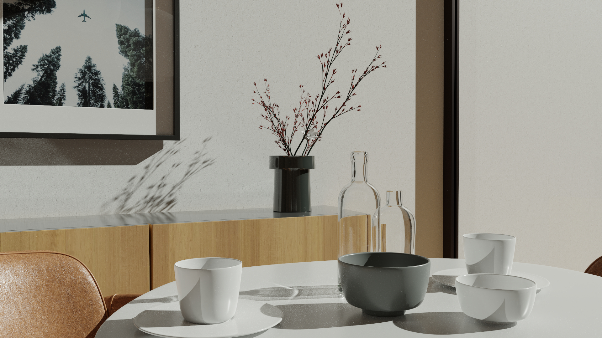

mischterlampe wrote: Thu May 07, 2020 10:54 am Nonetheless, the caustics of the glass bottle are very weak
The sun is at scale 4. With scale 1 and clamping off, caustics are stronger.
This is Ryzen 3900x equivalent to 1 hour
Border render

Can you try to render the animation with the latest built (when it is ready, in a couple of hours) and disabling the HDR light source (i.e. with only the sun light source) ?
I may have spotted the chain of events that is the source of the problem.

I have now rendered the scene with latest build and HDRI, sky or no background: everything flickers.
But worse is the speed loss: feels like 10 times slower and therefore looks noisier.
Instead I have another suggestion.
Dade wrote: Sun May 10, 2020 10:59 am Knowing the average luminance of the image to render is the only Metropolis requirement but it is not a trivial one: it must be know before doing the rendering (i.e. requires the crystal ball). If the estimation is wrong the result will be brighter/darker than the correct solution.
Why not introduce a manual setting for the average luminance?
By default it should be on auto, like the previous version after issue#312 fix which was rather stable with good light, only not in difficult circumstances like Danish Mood with HDRI.
But there would be an advanced setting similar to how clamping is implemented: the auto setting is already shown as a suggestion.
This would make animations possible even with moving glass bodies, as long as the lights are not animated.
Also we could use a BiDir render to gauge the correct brightness (somehow light tracing never matched BiDir results).
And no further development time would be wasted on this topic, the old speed advantage would be back too.
Of course this would also mean adjustable caustic brightness which is biased, but so what?

I also rendered with the latest version 41da08d
and I get flickering, too.
https://streamable.com/wsu0yd
World Setting has no light, just one sun, 4k samples.
