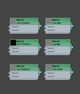

A new set of maps are on the way and will be finished soon.

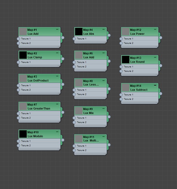

Math Maps are almost finished only part that remains is Round, Mouldo, and Multiply that I can not find anything about in wiki.
The "scale" texture performs multiplication in LuxCore.
Modulo has the inputs "texture" and "modulo".
Round has the inputs "texture" and "increment".
Maybe the Blender addon export code helps, although it is a bit distant from a direct property representation: https://github.com/LuxCoreRender/BlendL ... th.py#L127

There's not really a minimum or maximum for these. The property type is technically "texture" (float or spectrum texture), but for user input you can use float.TAO wrote: Tue Dec 22, 2020 4:50 pm Also, what is the minimum and maximum amount for increment in Round and modulo in Modulo, and what is the properties type. (int, float, double ....)
Yes, the scale texture.TAO wrote: Tue Dec 22, 2020 4:50 pm Do we have any multiply for blending color or images like the photoshop multiply layer option?
Check the implementation: https://github.com/LuxCoreRender/LuxCor ... le.cpp#L30
Thank to B.Y.O.B, the full set of math maps are ready now.

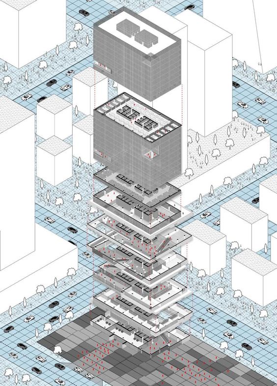

Do we have any toon shader or such as what we can see in Arnold and Vray for isometric renders?
Nope, not an outliner but we have flat shader under the form of ALBEDO AOV, it is used by BlendLuxCore for some pre-view task.TAO wrote: Wed Dec 23, 2020 1:41 pm Do we have any toon shader or such as what we can see in Arnold and Vray for isometric renders?
I think that's not a bad idea to have an "outlines" shader or event a few toon shaders too. After I'm finishing that part I will try to implement one if it's okay.
Many architectures need "outline" shaders and they asked me for them.
Also, toon materials are great for animation.
