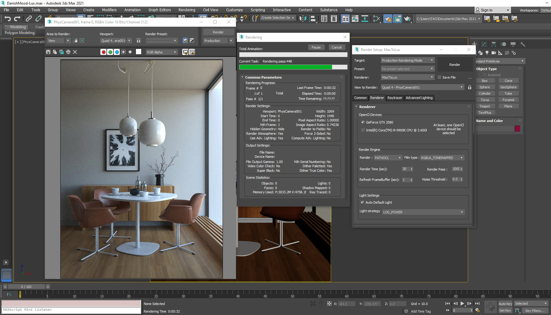

The very first look of the 3dsmax 2021 plugin, will be out soon after fixing the problem with openImageIO library.
