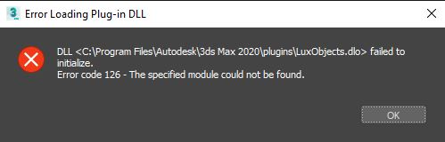

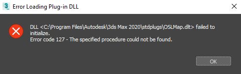

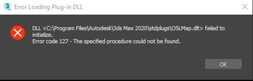

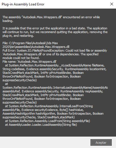

eliasdiaz3d wrote: Mon Dec 14, 2020 7:57 pm i try install luxcore in max 2020 and i get this errors and luxcore dont show in renderer list
Can you check the 3dsmax Root directory and see if openImageIO.dll exists and what the size of it?
Also if it is possible for you just replace it with this version and let me know if it's working correctly.
OpenImageIO.zip
Remember to unzip the archive first.
the size of the file was 8.20mb

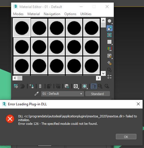

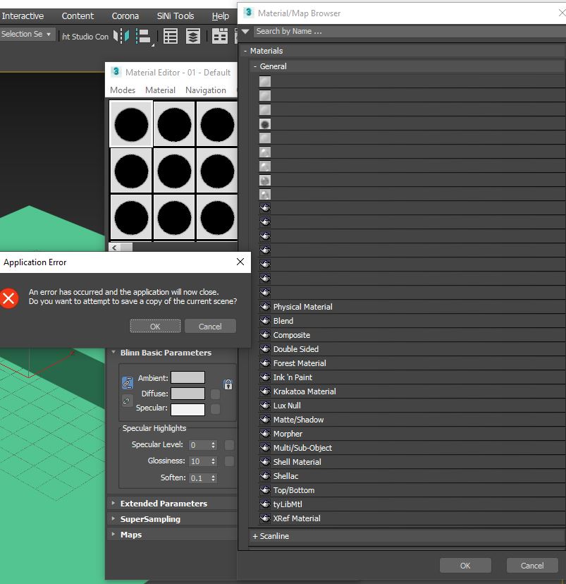

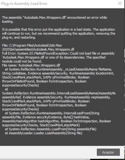

i replace with the file but i get this new errors, MaxToLux show in renderer but dont load materials or lights when i tried load materials show me another error and 3ds max crash

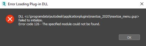

Maxtoa is about conflict with Arnold is all about openImageIO.dll
did you update Arnold renderer recently to the last version?
8.510kb is the same version that 3dsmax 2021 using and had a conflict with the one used in luxcorerenderer.
it's not going to work with Arnold yet, I'm on it to fix that issue
Sorry for the inconvenience. if you read the error is MaxToA means Max to Arnold it's not about the LuxCore
First, uninstall the plugin and then add these files to the 3dsmax root.
We will fix the issue very soon to work with Arnold renderer at the same time.
openimageio.zip
(2.21 MiB) Downloaded 363 times

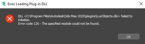

i uninstal arnold and replace opeinimageio file but i keep getting this errors
Please send me a screenshot of your 3dsmax root openimageIO.dll

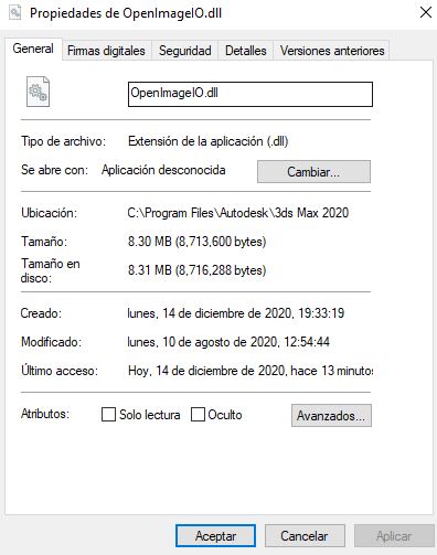

TAO wrote: Tue Dec 15, 2020 12:42 am Please send me a screenshot of your 3dsmax root openimageIO.dll
is this
It's the same 8.2 mb. the one I send to you is 13mb. in this post viewtopic.php?f=5&t=1010&start=240#p27140
Please replace it with this one.

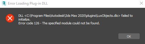

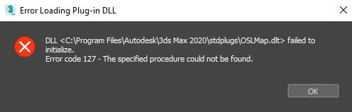

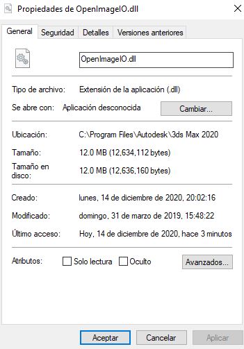

TAO wrote: Mon Dec 14, 2020 11:38 pm
OpenImageIO.zip
nothing same errors show it
Check your inbox i send you a private message so I can check the issue by myself.
as I said before it's not going work with the latest version of Arnold and still some of the Arnold files need then a specific version of openImageIO
The very first look of the 3dsmax 2021 plugin, will be out soon after fixing the problem with openImageIO library.
