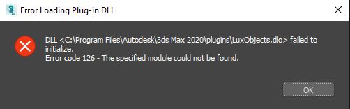

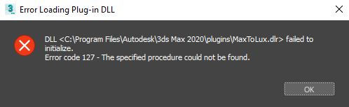

    i try install luxcore in max 2020 and i get this errors and luxcore dont show in renderer list
    eliasdiaz3d wrote: Mon Dec 14, 2020 7:57 pm i try install luxcore in max 2020 and i get this errors and luxcore dont show in renderer list
    Can you check the 3dsmax Root directory and see if openImageIO.dll exists and what the size of it?
    Also if it is possible for you just replace it with this version and let me know if it's working correctly.
