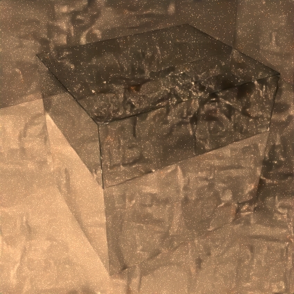

Hi Dade, please help me with this. In production this is a huge problem because most shop displays and counters have this kind of design, a glass cage of which we want to appreciate the glass thickness and consistency, and the products behind. At the moment our user cannot deal with this kind of design because behind the glass everything get's dark and makes the glass look like a smoked glass. Thanks for your patience.
Re: issue with glass
Posted: Fri Oct 29, 2021 11:08 am
by Dade
The last scene you posted shows nothing (it is just black). Try to post a scene that show this problem:
daros wrote: Tue Oct 12, 2021 1:07 pm The problem shows up as soon as the light is bounced by a slightly glossy material.
The only difference between this scene and the previous ones is that the wall material, which is reverberating the light to our cage, is slightly reflective/glossy.
The luxcore scene of the last picture is exactly the one i sent you today. If you replace the material assigned to the "space" layer with a white matte you get again the correct result.
You have never posted this scene.

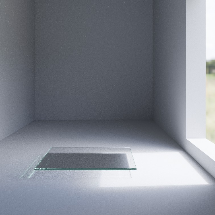

Look like I have the issue back on last build : obviouslly the shadow under the glass shit is to dark.
Light tracing ON
Light tracing OFF
File:
glass_bug.zip
(1.62 MiB) Downloaded 383 times

Sharlybg wrote: Fri Nov 12, 2021 2:08 pm Look like I have the issue back on last build : obviouslly the shadow under the glass shit is to dark.
It is the very same definition of SDS paths: you need to enable caustic cache to see the light, trough glass (S), on the floor (D).

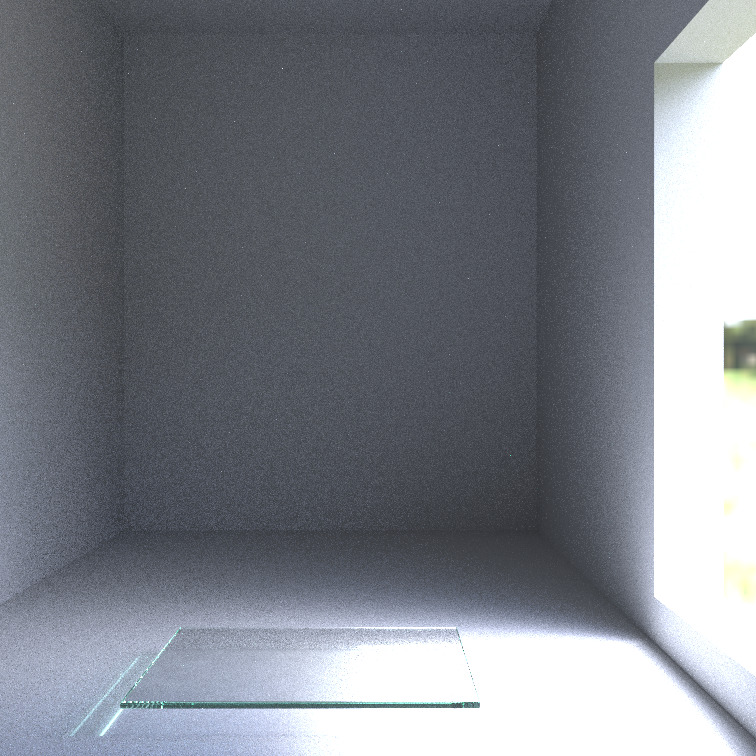

by Sharlybg
This is even what look strange to me. In fact in cycles you obtain a very different result
And we all know how """good""" this engine play with caustics. And there is nothing special:
simple glass shader. The luxcore shadow look obviously too dark, like light rays aren't able
to pass through the opened side arround the glass.
cycles
updated with cycles shader:
glass_bug+cycles.zip
(1.63 MiB) Downloaded 353 times
Posted: Sat Nov 13, 2021 6:03 pm
by epilectrolytics
Sharlybg wrote: Fri Nov 12, 2021 2:08 pm Looks like I have the issue back on last build : obviously the shadow under the glass sheet is too dark.
It does not work with PathGPU + indirect cache alone.
It does work with PathGPU + indirect + caustic caches or
with PathGPU +indirect cache + bright shadow color (fastest way).
It does also work with BiDir Metro or PathCPU Metro without caches (slow).
Curiously it does not work with BiDir Sobol or PathGPU Sobol without caches :?:
Posted: Sat Nov 13, 2021 10:45 pm
by Dade
Sharlybg wrote: Sat Nov 13, 2021 4:11 pm
It is a fake result you can obtain in LuxCore using shadow transparency (this is what all previous posts in this threads are about).
