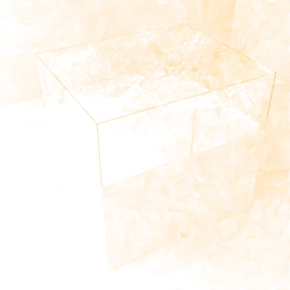

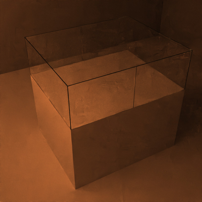

Hi dade, i hope this time we see the scene in the same way.
The only difference between this two renderings is the fact that in the dark one the wall material is a glossy plastic.
Strange is that the glossy plastic version looses a lot of light compared to the matte white version.
The other problem is that in the glossy plastic version the light do not travels through the glass despite the shadow color of the glass is white.

daros wrote: Fri Oct 29, 2021 12:52 pm The only difference between this two renderings is the fact that in the dark one the wall material is a glossy plastic.
Emm, no, the walls are "glossytranslucent", it is a transparent material:
You need to switch to a solid material or the scene doesn't make any sense (especially with the outside sky).
I reworked the test scene to make sense to me and I fixed a problem with some type of shadow ray going trough shadow transparent objects in BiDir:
It may, or may be not, related to your problem.

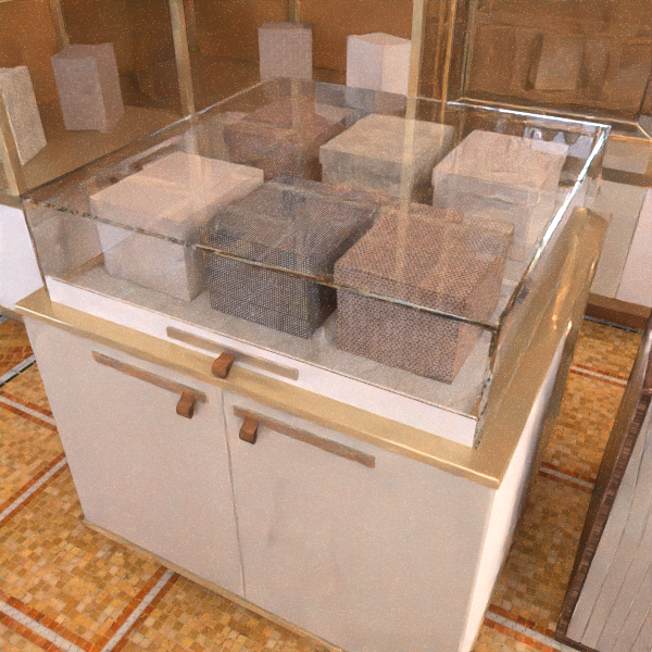

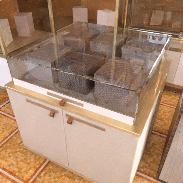

Hi dade, thank you very very much for this fix!
Big difference!
Before:
Now:

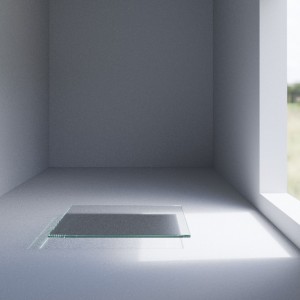

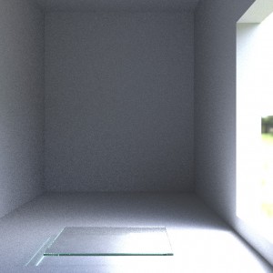

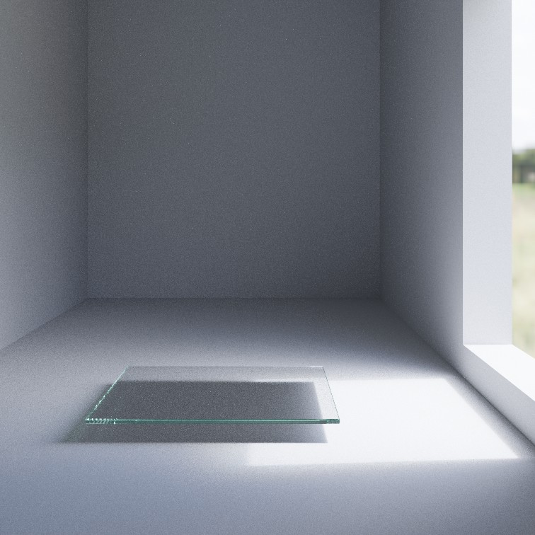

Look like I have the issue back on last build : obviouslly the shadow under the glass shit is to dark.
Light tracing ON
Light tracing OFF

Sharlybg wrote: Fri Nov 12, 2021 2:08 pm Look like I have the issue back on last build : obviouslly the shadow under the glass shit is to dark.
It is the very same definition of SDS paths: you need to enable caustic cache to see the light, trough glass (S), on the floor (D).

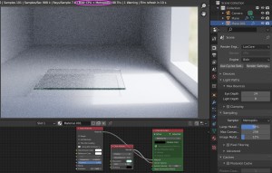

This is even what look strange to me. In fact in cycles you obtain a very different result
And we all know how """good""" this engine play with caustics. And there is nothing special:
simple glass shader. The luxcore shadow look obviously too dark, like light rays aren't able
to pass through the opened side arround the glass.
cycles
updated with cycles shader:

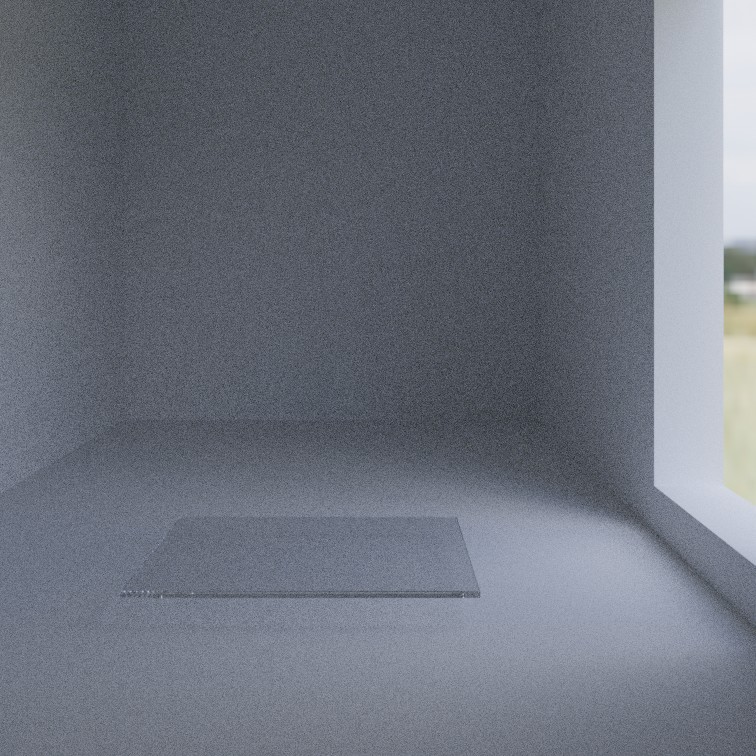

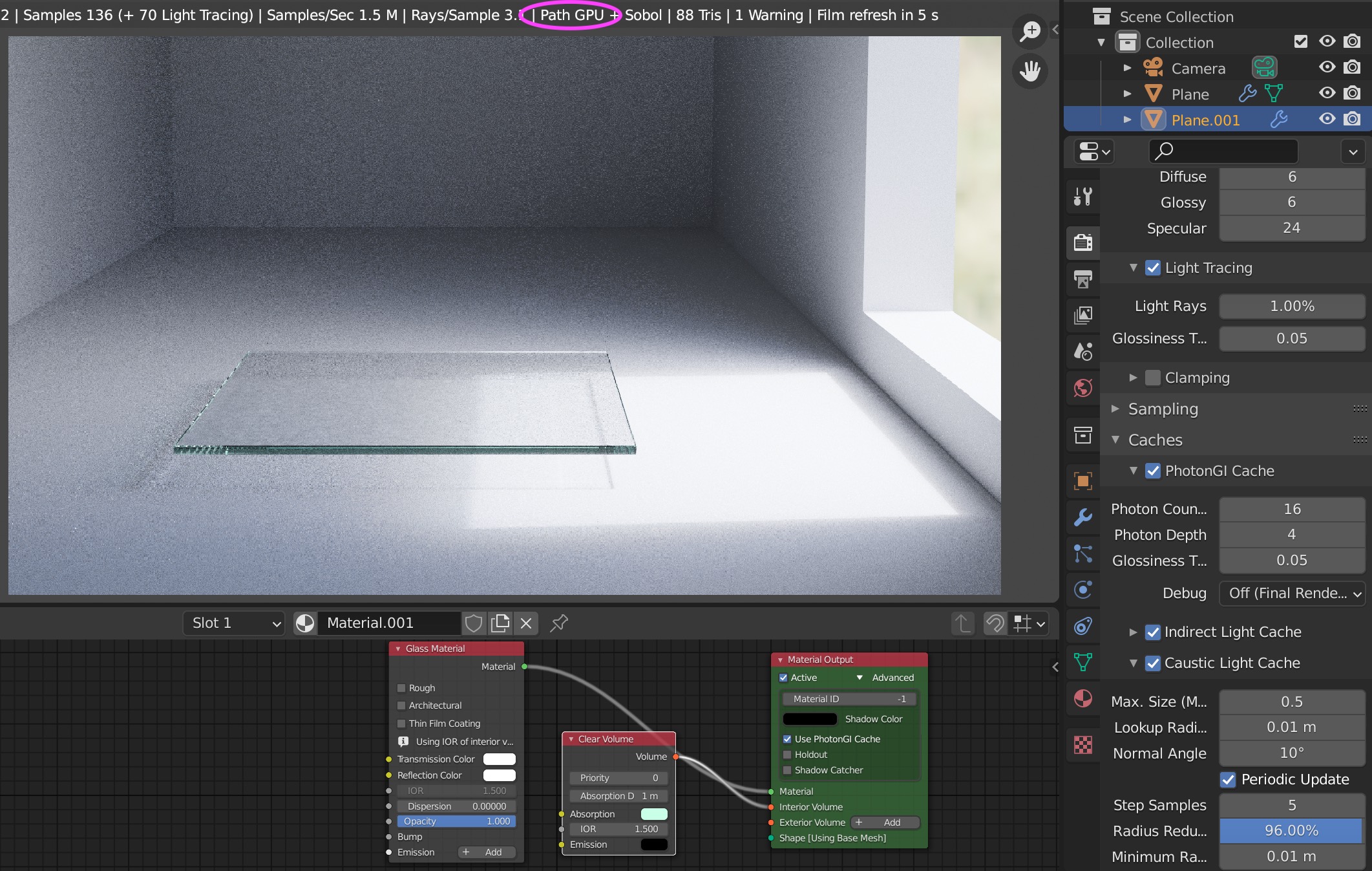

Sharlybg wrote: Fri Nov 12, 2021 2:08 pm Looks like I have the issue back on last build : obviously the shadow under the glass sheet is too dark.
It does not work with PathGPU + indirect cache alone.
It does work with PathGPU + indirect + caustic caches or
with PathGPU +indirect cache + bright shadow color (fastest way).

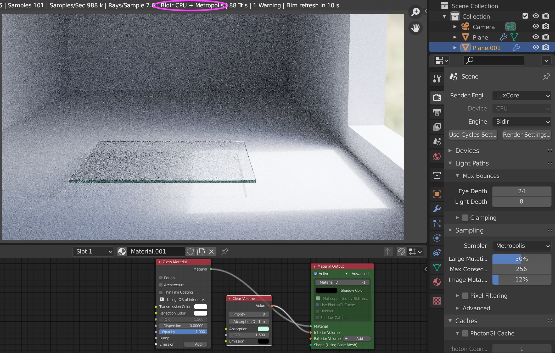

It does also work with BiDir Metro or PathCPU Metro without caches (slow).
Curiously it does not work with BiDir Sobol or PathGPU Sobol without caches :?:
Re: issue with glass
Sharlybg wrote: Sat Nov 13, 2021 4:11 pm
It is a fake result you can obtain in LuxCore using shadow transparency (this is what all previous posts in this threads are about).
