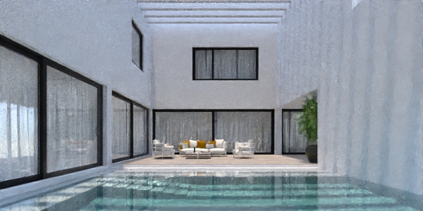

by daros
Hi, new issue:
This is what i get from this scene with volumetrics turned off:
and this is what i get wen i turn volumetrics on, water has gone:
it's a volume priority issue?
if we have the fog volume surrounding the scene set as interior volume, the walls as exterior volume, and the water as interior volume, which are the priorities which we have to assign to each volume?
We tried with fog volume set as priority 0, the walls as priority 0, and the water as 1 but the result is the same...
here the luxcore scene

Naturally, solids have higher priority than fluids, which have higher priority than gases.

by acasta69
daros wrote: Thu Sep 23, 2021 8:21 am
It seems that all volumes in your scene are defined with the same ior = 1.5, so no difference between fog and water...
scene.volumes.envVolume.ior = "1.5"
Re: Volumetrics issues
Posted: Thu Sep 23, 2021 1:34 pm
by daros
Thanks acasta69, sorry for the stupid error.

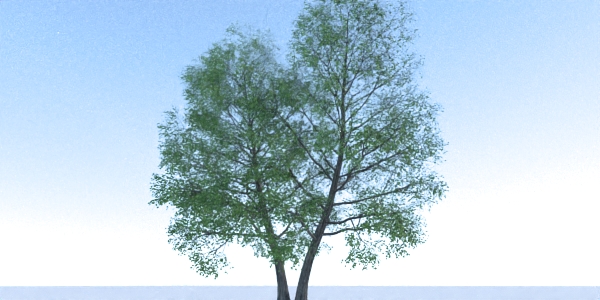

Posted: Thu Sep 23, 2021 3:27 pm
by daros
and one more question but i cannot upload the file today.
here is a tree with fog off:
and here we have a very thin fog, about 10km visibility
why the shading of the tree shows up so differently?
tomorrow morning i can upload the luxcore scene.
