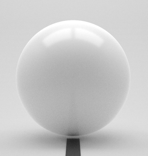

Uh... regarding the disney material... the white halo at the tangent on bright materials is my luxcore problem number 3

The material here as well as the Luxcore disney doesn't have SSS of any sort.
This bright rim is appearing at grazing angle in certain lighting condition.

Try to wonder what I'm asking ... right, a test scene.
Have you tried to use the Disney parameters with Cycles ?

Sorry here it is :
Rim.zip
(1.78 MiB) Downloaded 1366 times

Is it a BiDir only problem ?
Path:
BiDir:
Re: Two well known luxcore problems.
Posted: Sat Aug 28, 2021 11:18 am
by Dade
Yes, it is easy to spot the problem using light tracing only rendering:
(the fireflies on the edges)

Do you think you can do anything to reduce this halo on bidir?
That would be great!
