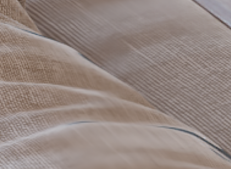

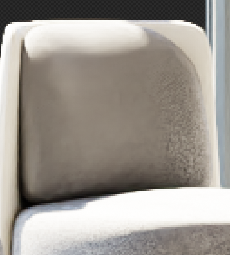

This is one situation where I think having the option to consider the albedo as totally clean and not prefilter it could be better, in this case we loose detail in the cloth texture because it's being interpreted as noise when it's not, and the scene has more than 3000 samples.
This is the denoiser output:
And this is the Albedo:
I can assure you that the Albedo is totally clean, but OIDN is considering that detail as noise I suspect, and that's why it's removing it from the final image.
So having this option I think can improve result in these situations, and I imagine that's what the option is useful for.

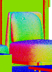

Here is an example with the three channels, Beauty, Albedo and Avg Shding Normal.
As you can see all the texture detail is being killed in the denoise process, and I think it is because the Albedo PreProcess detecs the texture detail as noise.
Albedo is noise free enough, at least to try it, you see it here a bit pixelated because it's a zoom, and the texture has a very fine grain detail, so the "noise" you see is part of the texture, not part of the render.
Beauty with noise blurrying the result:

Normal
