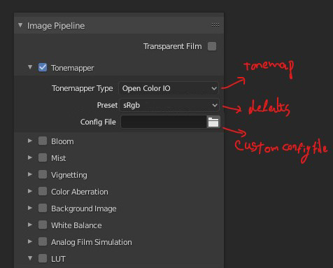

TAO wrote: Fri Aug 13, 2021 11:08 am Add color space rollout In the camera option section below the LUT.
Camera is probably better to be associated with the "Outputs", not the "Inputs" lable. Here you should be able to define the config file and the color space output or display out.
This is also part of the tone mapping process, so it should be a tone mapper option inside the combo box, not a separate tab.
I can add utility functions to LuxCore API to have the list of available "Color spaces", "Displays", etc. So you can use a combo box instead of generic text input.

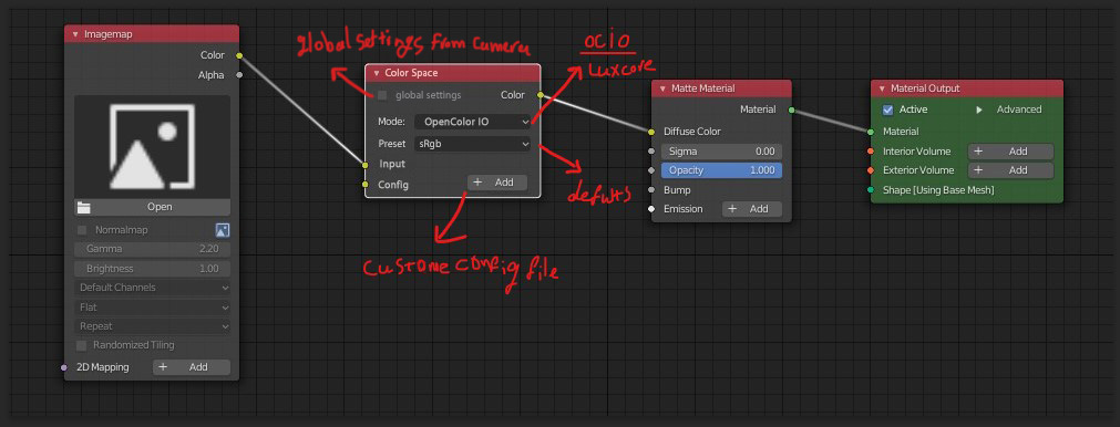

TAO wrote: Fri Aug 13, 2021 11:08 am Add color space node in the material editor, so it can be used for textures and other nodes.
Yes, correct, you probably want to have a "default config" option by default (i.e. the OCIO config file used for the camera).

For node editor, adding a global option to read defaults camera settings from the camera, also adding a few presets.
inside the camera tone mapper section, adding the OCIO as a tone map with a few preset and the ability to select a config file.

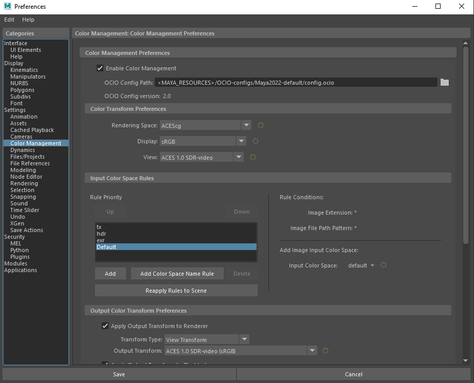

I dig a little bit about how the other rendered in other software workaround color management and I found Arnold and Corona used The Academy Color Encoding System (ACES) and implemented in just one single global option for all input, output, etc.
https://docs.arnoldrenderer.com/display ... S+Workflow
Good article to read that has more details in the Color Management article compare to blender documentation.

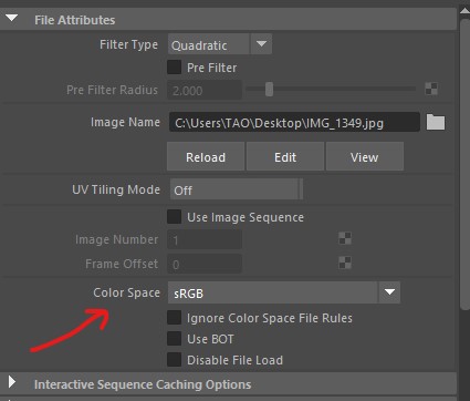

How Maya manages OCIO/ACES.
Global settings in 4 sections, config file, input, transform, output
I think if i add one section in the image pipeline and put all OCIO settings on it i will be exactly what we need. of course if the OCIO color management is selected and enabled the blender color management needs to be set as raw as it is in LUT at the moment.
in material editor one option for select color space.

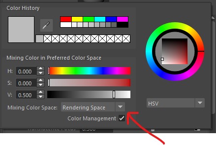

for colors
for textures
it can work in the blender with a simple color space node.
