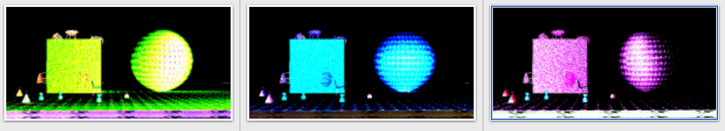

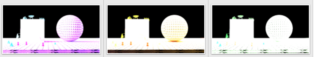

The main question is, why images written by pipeline are different that the one saved by film.
I have folowing pipelines:
film.imagepipelines.1.0.type = "NOP"
film.imagepipelines.1.radiancescales.1.enabled = 1
film.imagepipelines.1.radiancescales.2.enabled = 0
film.imagepipelines.1.radiancescales.3.enabled = 0
film.outputs.5.type = "RGB_IMAGEPIPELINE"
film.outputs.5.filename = "/home/node/matadorNode/tmp/0_FI_68803_271618_0000_multilight_74956_12.exr"
film.outputs.5.index = 1
film.imagepipelines.2.0.type = "NOP"
film.imagepipelines.2.radiancescales.1.enabled = 0
film.imagepipelines.2.radiancescales.2.enabled = 1
film.imagepipelines.2.radiancescales.3.enabled = 0
film.outputs.6.type = "RGB_IMAGEPIPELINE"
film.outputs.6.filename = "/home/node/matadorNode/tmp/0_FI_68803_271618_0000_multilight_74956_13.exr"
film.outputs.6.index = 2
film.imagepipelines.3.0.type = "NOP"
film.imagepipelines.3.radiancescales.1.enabled = 0
film.imagepipelines.3.radiancescales.2.enabled = 0
film.imagepipelines.3.radiancescales.3.enabled = 1
film.outputs.7.type = "RGB_IMAGEPIPELINE"
film.outputs.7.filename = "/home/node/matadorNode/tmp/0_FI_68803_271618_0000_multilight_74956_16.exr"
film.outputs.7.index = 3
And this produce a correct images:
Than I open the film from flm file.
I save each RADIANCE_GROUP by calling:
film->SaveOutput(fileName, OUTPUT_RADIANCE_GROUP, and Properties with id set to 1, 2, 3
And this is what I get:
I thought that I will get identical images.

Posts: 309
Re: reading flm files
The ones from the pipline seems to be fine.
The from FLM is very strange...it seems that somewhat has been inverted but i cannot figure our what.
