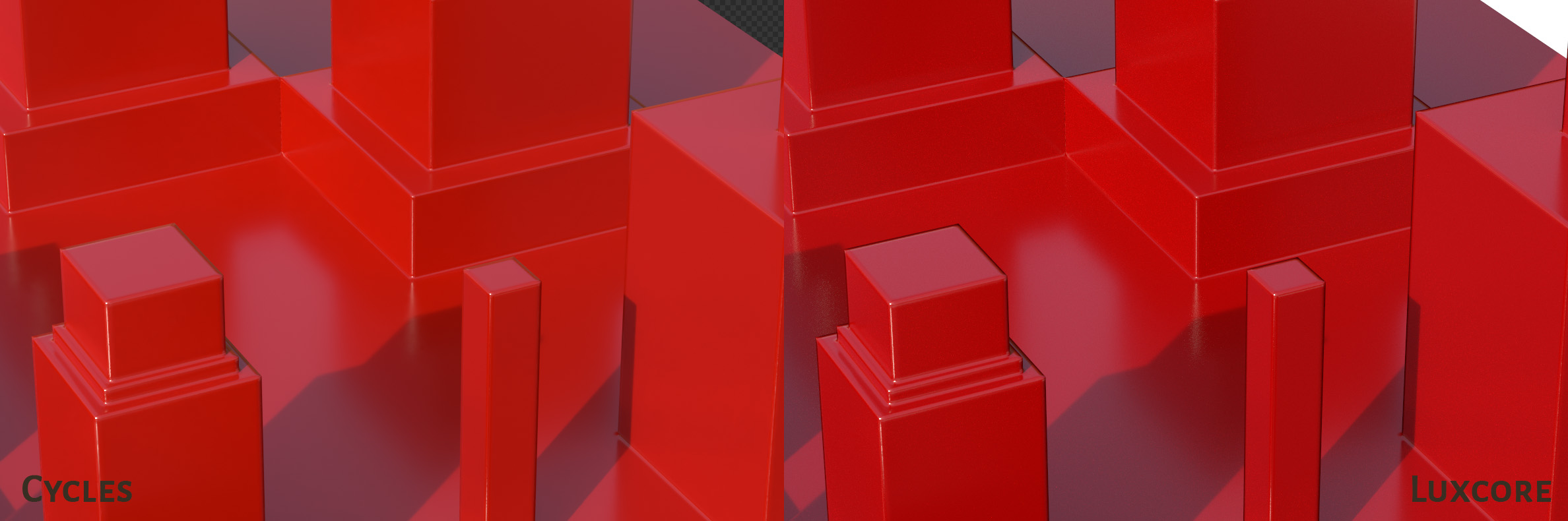

One other thing though. Do you have an idea, why in Luxcore the edges are that black at a glancing angle when using the bevel normal map? It's more subtle using Cycles.

AndreasResch wrote: Thu Mar 04, 2021 1:28 pm One other thing though. Do you have an idea, why in Luxcore the edges are that black at a glancing angle when using the bevel normal map? It's more subtle using Cycles.
I have the feeling that the bevel is all placed on one face (so the shading normal goes from 0 degree to 90 degree) instead of being split between the two adjacent faces (so the shading normal goes from 0 to 45 degree on one face and from 45 to 0 on the other face).
If you overlap the UV unwarp and the normal map, you should see if the bevel is all on one side of the edge or the edge is in the middle.
I use the same map in Cycles and Luxcore here. Cycles just renders the edges a bit brighter and in doing so, more pleasing to the eye. The same for Eevee. So if that was possible in Luxcore as well, that would be nice.

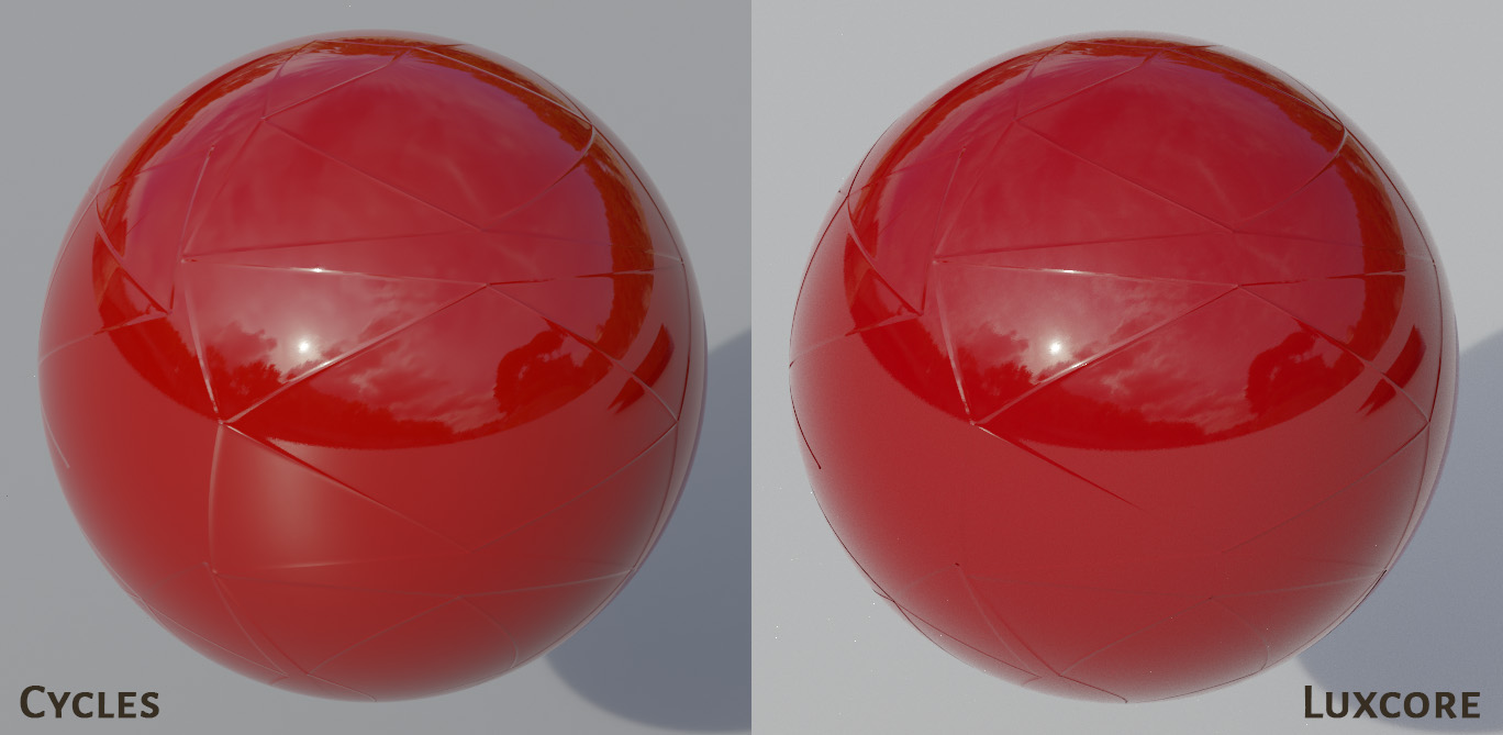

I slammed the normal map that I baked earlier onto a sphere to see what's happening. While the normal mapping effect looks pretty identical in facing areas, on a glancing angle the Luxcore version shows dark areas that are not visible in the Cycles version. Maybe that's the same effect that we can see in the other rendering with the blocks.

I have seen the exact same issue in other renders. If you use a Normal bump it will happen, it's the same for the regular images on the bump slots too.
I tried non-color images for bump and normal bump and it helps a lot but not completely.
Re: Baking Bevel in Cycles
Cycles has code to ensure that the normal stays valid after bump/normal mapping is applied: https://developer.blender.org/D2574
Maybe this is responsible for the difference?

B.Y.O.B. wrote: Thu Mar 04, 2021 7:01 pm Cycles has code to ensure that the normal stays valid after bump/normal mapping is applied: https://developer.blender.org/D2574
The resource you mention is exactly what happens here in render for me. i get the same results as the old image in the link you mention.
Except for a little bit of darkness for using the color image on the bump.

Hmm. If it also happens to bump maps, this would explain why a wood material that I tried to convert to Luxcore looked a bit off. It had a very fine bump map that just looked odd, when looked at from a glancing angle.
