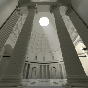

I am really liking luxcore more and more. Im starting to get some good renders now.
Single HDRI, no lights except this, set as "Hemi Sun"

The long cache processing time is probably due to the scattering volume seen in the image, producing volumetric cache entries.
Re: Very long wait for caches enabled
epilectrolytics wrote: Mon Nov 09, 2020 11:00 pm The long cache processing time is probably due to the scattering volume seen in the image, producing volumetric cache entries.
Entries on volumes should be disabled by default :?:
I thought this would be easy to test, so I removed the volume, cache processing time didn't change.

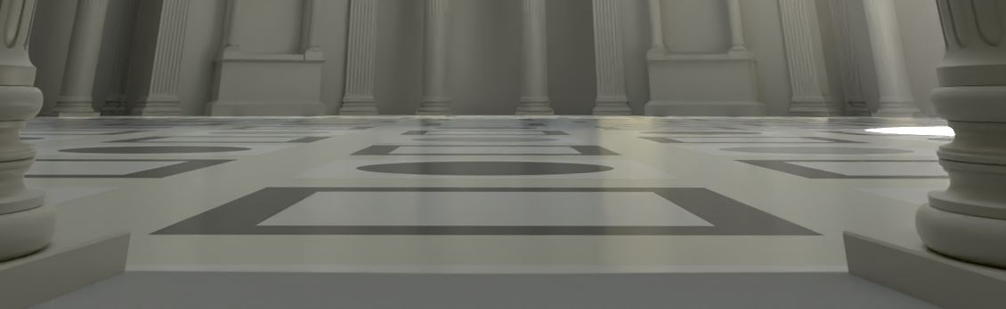

I've also noticed some reflection errors with PhotonGI cache, see attached. Seems to only be a problem when viewed at a glancing angle to the surface. What parameter can be changed to improve this?
nigma46 wrote: Wed Nov 11, 2020 11:25 pm I've also noticed some reflection errors with PhotonGI cache, see attached. Seems to only be a problem when viewed at a glancing angle to the surface. What parameter can be changed to improve this?
Can you show the ground truth render?
