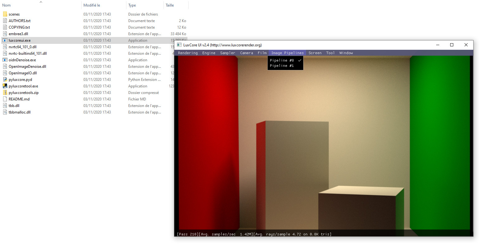

Re: Luxcore vs real Photo
Can Luxcore standalone use .cube LUTs file for tonemapping ?
B.Y.O.B. wrote: Tue Nov 03, 2020 5:57 pm Yes, it is done with an imagepipeline plugin: https://wiki.luxcorerender.org/LuxCore_ ... _COLOR_LUT
Example usage: https://github.com/LuxCoreRender/LuxCor ... dr.cfg#L76
I can see the option but nothing to load the Luts in the viewport. is there a special process to follow ?
BTW this return error with Luxcore standalone and wann't render.
00000.zip
(52.44 KiB) Downloaded 468 times
I think i have understand how it should work. just that i can't apply it with my file not working with standalone luxcore.
