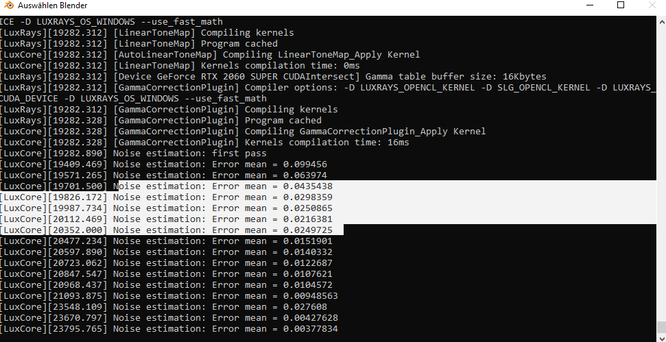

Posted: Mon Nov 23, 2020 4:53 pm
by mischterlampe
I figured out a small workaround. If you select a few lines in the console
and you wait a little bit (up to a few minutes), blender gets responsive again. Rendering is going on, the rendering viewport is not updating, but you can move inside the image and work with blender.
If you want to fo back, so the rendering is updating, click inside the console and press "ESC" and wait a little bit.
I think this is helpful if you renderings will take some time.
