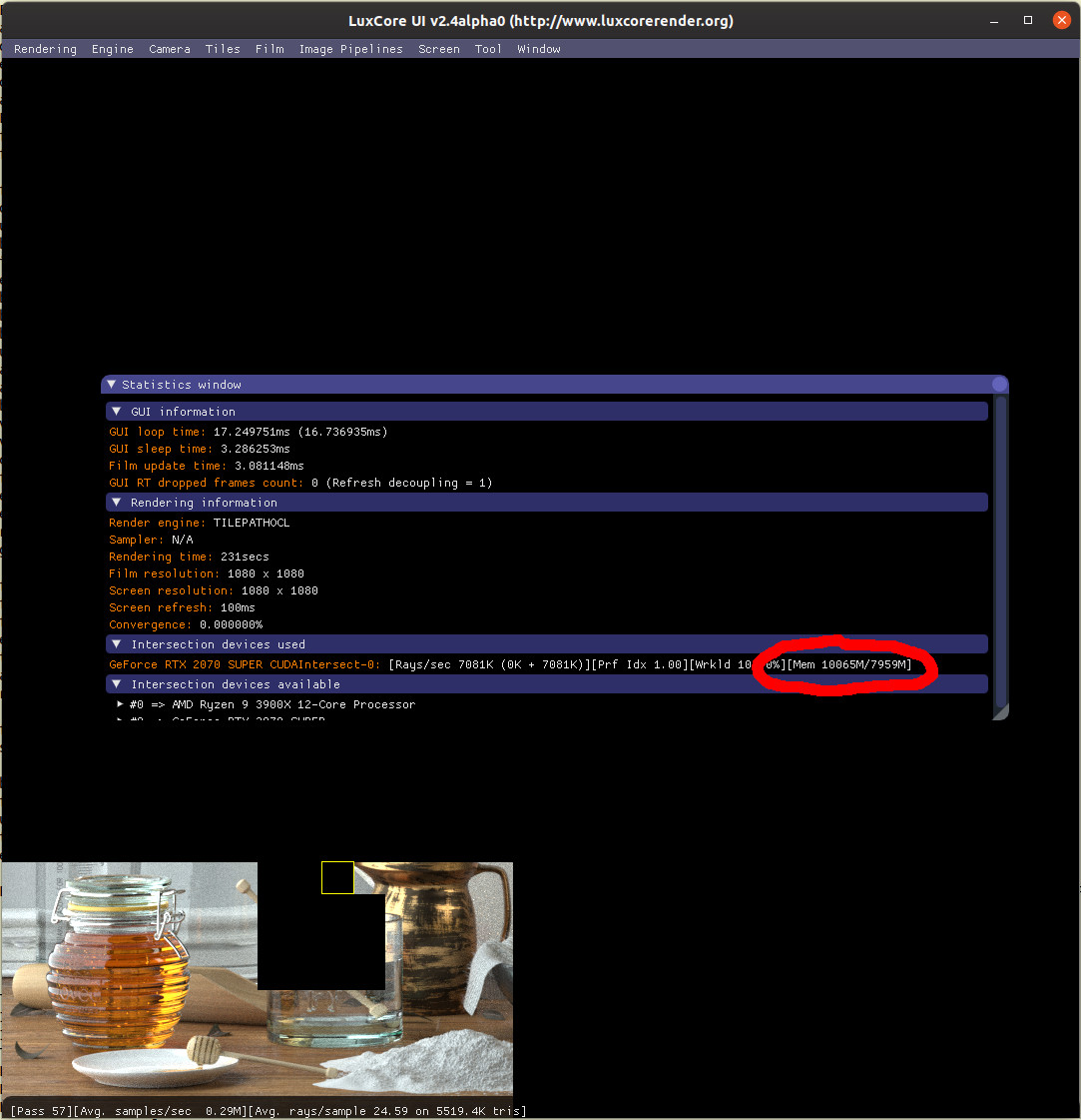

I .. couldn't ... resist ...
Very first out of core rendering, 10+GB scene rendered on a 8GB card (8GB used by the OS, applications, etc. too, not a dedicated compute-only GPU):
The scene has more than 8GB of artificially up scaled textured to use more ram:
[LuxRays][26.806] [Device GeForce RTX 2070 SUPER CUDAIntersect] ImageMap descriptions buffer size: 784bytes (OUT OF CORE)
[LuxRays][26.809] [Device GeForce RTX 2070 SUPER CUDAIntersect] ImageMaps buffer size: 4181238Kbytes (OUT OF CORE)
[LuxRays][36.726] [Device GeForce RTX 2070 SUPER CUDAIntersect] ImageMaps buffer size: 3806677Kbytes (OUT OF CORE)
[LuxRays][46.090] [Device GeForce RTX 2070 SUPER CUDAIntersect] ImageMaps buffer size: 551053Kbytes (OUT OF CORE)
Out of core rendering is going to be a delicate beast (notice how I'm using tile rendering to have good sample locality) but still looks like black magic.

Pretty cool. What's the performance hit though?

Euh what :shock:
You're doing out of core right now and it work ? Only for Nvidia i guess :mrgreen:

Quite big, a 50% slower in this first test but it is all about how much "locality" you have (i.e. GPU ram is used like a cache so it is all about the cache hit rate). I'm thinking to some special SOBOL option, dedicated to out of core rendering, to improve the samples "locality".
At the end of the day, as usual, there no free lunches, you have to give something (rendering time) to get something (bigger scene rendering).
P.S. Indeed, it is CUDA only stuff.
